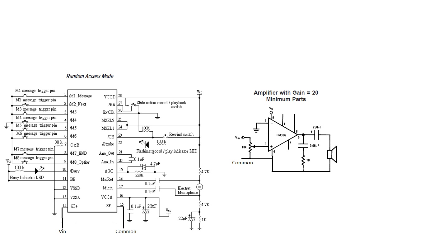

Sure thing.... Here it is.
I have have 2 different sections : the recorder IC connected to the audio circuit. the connections Vin and common between the 2 circuits shown.
Edwards

I've gone through the HK-828 datasheet. It rather looks like a bridged audio output with SP+ and SP- terminals without a common ground. So a normal attenuator cannot be used for connecting to LM386. Using a load lower than 8ohm impedance may damage the IC. 16ohm is actually recommended.
A coupling audio transformer may work here. However I won't recommend to continue this project because this would be a worst case of disturbing/damaging the IC having a bridge mode audio output :)
Use a single output from the recorder, attenuate it with two resistors in series to ground (or a volume control pot) and capacitor-couple it to the input pin of the LM386 amplifier. The coupling capacitor is needed since the output pin of the recorder has a DC voltage on it and the LM386 amplifier's input must be at 0VDC.
A transformer is not needed.
Hi audioguru and transistor495,
Your suggestion of using a single output from the chip to amplifier makes sense.
