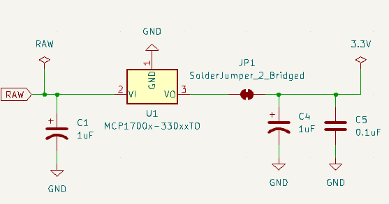

Hello all,
I am a student trying to see if I can design a lower power version of the pro mini than what one can buy. This is for a bigger project of mine where I look into energy harvesting and if it can extend battery life for a low power application. I have done this schematic in KiCAD following the arduino schematic for the pro mini while tweaking a few things like using another voltage regulator and having no power LED since that is what I've seen people do to the base pro mini to get power consumption down.

This is the KiCAD schematic from me:

This is for the voltage regulator:

I understand it's not quite pretty or space efficient but I wanted to hear opinions on its viability like if it would actually work or if I overlooked anything. I would appreciate any advice or suggestions for this. Also are the capacitors here supposed to be the load capacitance of the crystal oscillator? I'm using the HC49 which has load capacitance of 20pF.
Thank you for your time, really appreciate the help
