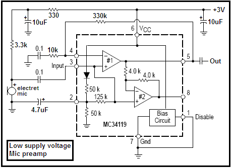

Hi Zach,
You need a mic preamp with a voltage gain of from 33 to 100. The minimum supply voltage for an LM386 is 4V. A few "ordinary" opamps have a min supp v of 3V but your battery will probably drop to 2V over its life. There are millions of new surface-mount opamps made for low-voltage cell phones and MP3 players but I haven't tried them.
An MC34119 bridged little power amp has a min supply v of 2V and would do the trick. It is an 8-pins through-holes IC and its supply current is from 2.5mA to 4mA. :lol:

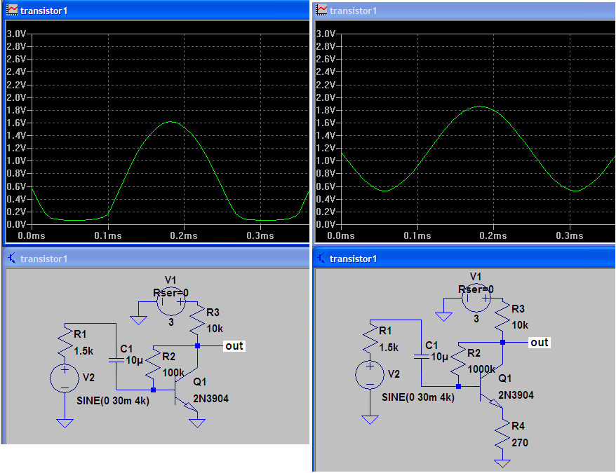

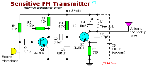

Hi Zach,
I dunno what MStechca is doing making a mic preamp from 2 resistors.
I simm'd the mic preamp from this popular FM transmitter. The results are awful as shown in my next post.

Hi again Zach,
The Sensitive FM Transmitter's mic preamp probably works OK in its circuit if you don't speak loud enough to have more than about 30mVp-p of output. With 30mV input then the transistor saturates like mad because it is incorrectly biased and its gain is too high. So I added an emitter resistor to reduce its gain and made it closer to correct bias.
It has more than 1Vp-p output with a 2V and 3V supply, with about 10% distortion.
This sim is with a "typical" transistor and changes a lot if the transistor has a higher or lower current gain.
