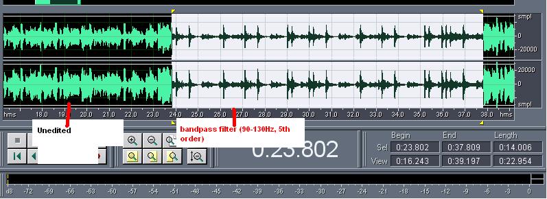

Ok, I got a picture. Now I'm thinking if I pass the signal through the bandpass filter, (I've checked a couple of songs, most of them seem to have a noticble beat in that freq. range). Then pass the signal through a differentiator, (to detect the sharp spikes of the beat), then I'd somehow convert the output of the differentiator to drive my clock signal.

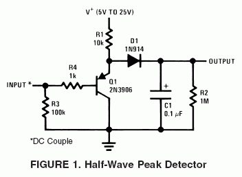

What about the LM3915:
1) Isn't it displaying the bandpass filtered output of the subwoofer amp?
2) Doesn't its output display the music's beat?
3) Is its input direct, so that its output is each cycle of the bass, or is the input made with a half-wave peak detector like in the datasheet? Then the output of the LM3915 would be pulses of the beat with fast edges to clock the shift-registers. The output of the LM3915 that you use for an output would need a pull-up resistor to be a logic clock.

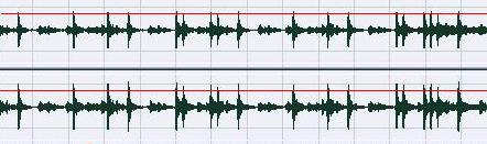

he wants something to switch the lights everytime the audio wave hits the red line ( shown in picture).
But with out a smoothing capacitor the lights might switch say 8 times every beat, instead of the desired 1 beat, 1 light switch.
What I would recommend is something like a 555 in a monostable setup. Once an 80 hertz wave trips the 555 timer, it's output stays high for a set amount of time ( eg. 150 ms). And then resets waiting for the next drum beat to set it off again. I'm only guessing 150ms, but that depends on how long the 80 hertz wave lasts and what kind of music you listen to.
this delay of 150ms means that it cant be tripped again for 150 ms. So you cant get 8 switchs in a beat, only 1 switch ( provided the beat doesn't last longer than 150 ms)
