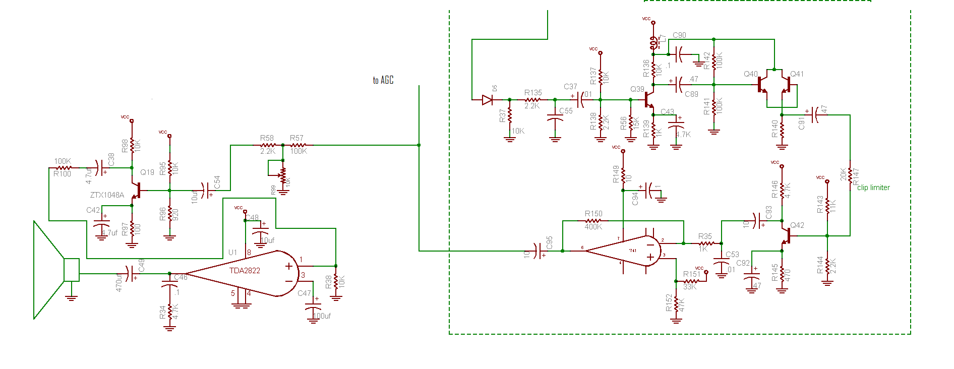

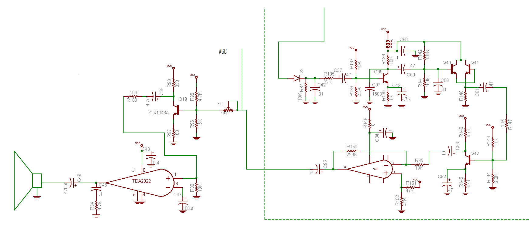

Well your right about the rf gain. It was done deliberately. I do not want much rf gain because of blocking & intermod. I prefer to use front end filtering for my rf gain which has not been done yet. I have two IF's where I did as much amplification as possible. I got the second IF up to about 1 volt P-P for weakest signal input. That was done to reduce the amount of audio amplification needed. Here is what my audio looks like:
I have the whole radio in like five cat food cans and so there are power wires coming out of each and are excessive in length. I know these are AC 60 cycle antennas. I should be able to cut them off today.
Anyway....grade me on my audio. you are the king there audioguru. ;)
Correction: the chip driver is not biased like that. I accidentally pulled up the wrong file. Here are the corrections:
1. R98 = 10K
2. R95 =10K
3. R96 =920 ohms
4. R100 = 100K
There are a couple of changes to the first audio amp too, like that 1500pf cap was removed. Very minor changes. I just don't have time to cut, paste and re-size the whole dern thing.

What's R99? - assuming it's supposed to be the volume control it's connected completely wrongly, also decouple your split supply for the opamp.
Oh hey Nigel. Didn't think anyone would be up. Forgot you are in the UK.
Anyway the OP Amp is decoupled. Thanks for reminding me. I need to put that in the schematic.
What do you mean by split supply? It is single supply.
Actually my volume control is different. I need to get the right file and post it.
Hang on...
You're generating a split supply with two resistors, it needs to be decoupled with a capacitor.
It's still completely wrong, how can you have never seen how to wire a volume control?.
I can't believe how much gain you are throwing away. Here is a list of the resistors that are at the beginning of each attenuator, along with the approximate attenuation of each divider:
R135 -9dB
R147 -24dB
R57 -33dB
R58 -12dB
R100 -22dB
You are throwing away approximately 100dB of gain! Throwing away gain means more noise and more distortion at the output.
All three of your transistor amplifiers almost certainly have gain from Vcc to the output. Any noise on Vcc will be amplified at the output of each stage. You need your audio amps to have good power supply rejection.
