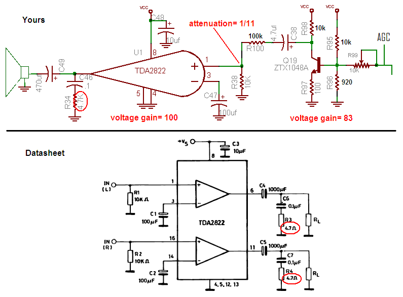

You have 4.7k for R34 when it is supposed to be 4.7 ohms.
Your circuit has a few audio attenuators:
1) R135 into the very low input impedance of R137, R138 and Q39 reduce the detected signal by about 1/23.
2) R100 and R38 attenuate the audio signal by 1/11.
3) R147 and the input of Q42 attenuate the audio by about 1/11.
So the total attenuation is almost 1/3000 times.
Your circuit has audio gain coming out of its ears. No wonder it oscillates:
1) Q39 has a voltage gain of about 150 if C43 is connected to ground.
2) Q42 has a voltage gain of about 100.
3) The 741 opamp has a voltage gain of 22.
4) Q19 has a voltage gain of 83.
5) The TDA2822 has a voltage gain of 100.
The total audio gain is 2,740,000,000 which is rediculous.
Your volume control is not a voltage divider.

AG, how did you calculate transistor amplifier gains? I looked through the thread and couldn't find any mention of the value of Vcc. As we know, gain for these amps is highly dependent on Vcc.
Also, you left out the attenuators caused by R57 and R58 (which I mentioned above).:) I came up with about 100dB attenuation, which is 100,000.
I can't believe how much gain you are throwing away. Here is a list of the resistors that are at the beginning of each attenuator, along with the approximate attenuation of each divider:
R135 -9dB
R147 -24dB
R57 -33dB
R58 -12dB
R100 -22dB
You are throwing away approximately 100dB of gain! Throwing away gain means more noise and more distortion at the output.

A 2N2222 or 2N3904 transistor is fine for audio. They have a frequency response up to about 300MHz. A capacitor from collector to base reduces the frequency response if you want.
Your circuit has way too much audio gain. It also has a lot of audio attenuation.
The transistors are powered directly from the raw power supply voltage without any filtering which causes hum.

You appear to have no idea what AGC is for?, audio compression will be really VERY useless on a radio, and make a badly performing design. Try looking at any commercial radio - they use IF and RF (delayed) AGC, and this is what you need to do.
About the only problem I have left which is very minor is when I hook it to an old linear power supply I will get a small amount of "common mode hum". Inside the radio I did all I can do like shielding the 1st LO and choking the incoming power and reducing the size of audio couple caps to minimize lower audio frequency coupling.
As Audioguru says, your design is completely lacking in anything to stop oscillation, feedback, and hum - stages need individual decoupling. You also really need to dump most of it, it's not needed, and is only making things worse instead of better.
The section you have posted is completely bizarre, if you hadn't mentioned it's supposed to be part of a radio I wouldn't have known.
I can only suggest you start entirely from scratch, and consult some existing circuits to see what you need, and what you don't - if you don't have an ARRL or RSGB Handbook, then go any buy one immediately.
