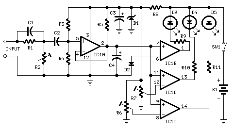

Hi friends, first of all i thanx for answers given to my previous questions.
Now i am making a power level indicator with circuit diagram and description below.
I am not getting how R2 is working as it is connected directly(not as a pot) and what is a purpose of diode D2. please explain...

* Example: set the output of the 1KHz sinewave generator to read 14V on the audio millivoltmeter (24.5W @ 8 Ohm). Set R2 until D3 illuminates, and be sure that D3 turns-off when diminishing a little the generator's output.
* Do the same with R7 for D4 and R6 for D5. The readings of the audio millivoltmeter must be 10V (12.5W @ 8 Ohm) and 4V (2W @ 8 Ohm) respectively.
The implication is that R2 is connected as a variable resistance with the wiper connected to one end such that the resistance with vary from zero to maximum resistance.
D2 acts as a ≈0.6 v (-) reference for the second comparator by virtue of the input bias current that flows through D2, supplied by the second comparator. The output saturation voltage of the first comparator is non-zero. D2 ensures that the second comparator will turn on when the first comparator turns on (when its output is saturated).
thanks, ccurtis..
got the working of D2 but i still have doubt in working of R2, its variable terminal is kept open, so how the resistor will vary??
is it a mistake?? or i should connect the variable terminal instead of fixed one??
Either it is a mistake or a funny hoax because the instructions indicate that R2 should be "set" until D3 illuminates.
My vote is that it is a mistake in the schematic and that R2 should be shown connected such that its resistance can be "set" to calibrate D3 for either an 8 ohm or 4 ohm speaker impedance.
R2 is shown as a variable resistor (rheostat).
Its middle pin connects to a pin at one end.
Not sure IC1A is going to be happy with a 1uF cap sitting directly on it's output. It looks like IC1A is trying to be some kind of pseudo-averaging circuit? It's a comparator, but the schematic shows it wired as an op-amp with the output tied back to the inverting input (?)
Power meters are a lot easier to build using an LM3914 or 3915, ie they are voltage reading meters which translate into power if the speaker impedance is known. Since you actually care if an amplifier clips, peak voltage levels are more interesting than an averaged level.
It's simply a variable resistor to ground. It forms an attenuator of the input signal with R1. The higher the amount of resistance at R2, the more signal goes into the comparator input. Less R2 resistance and more voltage drop across R1 = less signal at the input of U1A1.
It's a lazy man's way to bias that input up to approximately 0.6V. The designer is relying on the bias current flowing out of the input of the LM339 to cause a VBE across the diode to ground. Since that determines the comparator's threshold, it's certainly not a precise design.
The datasheet of the LM339 from ST Micro shows the output of the comparator with a huge compensation capacitor to ground so that it performs like a very low frequency opamp.
It just looks like a squirrely circuit to me. If I want an op-amp, I'll put one in and adjust the compensation/gain components to set the bandwidth.
The other thing is: exactly what is it trying to measure? Given the "input buffer", it sure can't be true RMS power, it's not even RMS voltage, and it sure isn't peak voltage. How can any of that be related to an RMS power meter? Looks flaky to me, it's basically an idiot light. The calibration is to send a 1kHz sine wave in and turn the pots until the lights go off? Junk.
OK, I will connect the R2 as R6 and R7 as it is not working for given circuit diagram. I have another doubt... Is it necessary to connect IC1A as buffer??
If i connect input directly(removing buffer) to the comparators (IC1B,C,D)
will the circuit work properly?? what is exact requirement of Buffer(IC1A)?
IC1A is more than just a buffer. It works as a clever peak detector owing to the fact it has an open collector output. The circuit will not work without it.

The circuit uses 3 output stages so it can indicate 3 different levels of noise. You can use only one output stage if you want.
so if D5 is the lowest level, I could eliminate R7, R9, R10 (and D3 and D4) and D2?... or should D2 be connected to the ungrounded side of R6
