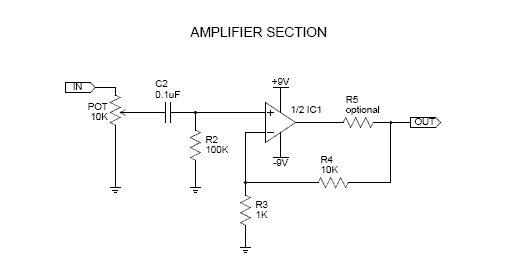

The last hurdle is the headphone amplifier, which I thought would be easy. I've been using the schematic attached from this website:
https://www.electro-tech-online.com/custompdfs/2009/03/cmoy-tangent-sch.pdf
That seems to be the most popular headphone amp design, so I followed it, but I'm not getting any output... Should I be using a different design?

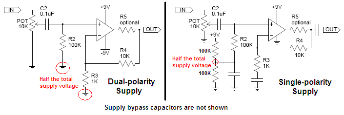

What OpAmp did you use? I dont think you really require a -9V for the ground. I think you should use 0V GND. I don't think you'll need the attenuation resistor on the output.
This should be super simple for you, its really just a basic non-inverting opamp setup.
The opamp circuit with a gain of 11 uses a dual-polarity supply because its inputs are referenced to ground. The negative battery can be eleminated if the input is biased at half the supply voltage with two resistors in series from the supply. Then the negative feedback resistor to ground must be capacitor-coupled to ground.
Headphones are from 8 ohms to 600 ohms. Most headphones are 32 ohms.
Ordinary opamps can drive 2k ohms. A few opamps can drive 600 ohms.
Use a power amp IC to drive low impedance headphones. Most power amp ICs have inputs that work at 0V and have built-in negative feedback.

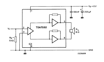

I happened to have a few TDA7052, but these don't seem to be working either - I got it to work with an 8ohm speaker, is it possible to get it to work with headphones? Should I hook the headphone ground to ground or Vcc/2?
An opamp does not have enough output current to drive low impedance headphones.
The TDA7052 amplifier has too much power, too much gain and too much distortion.
What is the impedance of each ear of your headphones?
Do you want stereo or mono?
The headphones are 32ohm - this problem seems tricky - I have quite a few op amps, many can drive loads down to 100ohm - that's a graph I didn't think to check when I purchased them.
Is there a way to decrease the power of the TDA7052? I just need a mono output.

The TDA7052 has a gain of 98 which is probably too high and has too much output power.
The LM386 has a gain of 20 which is good and has a reasonable amount of output power.
Adding a 220 ohm (or less for more power) resistor in series with the output of the amplifier to the headphones will reduce the output power for headphones.

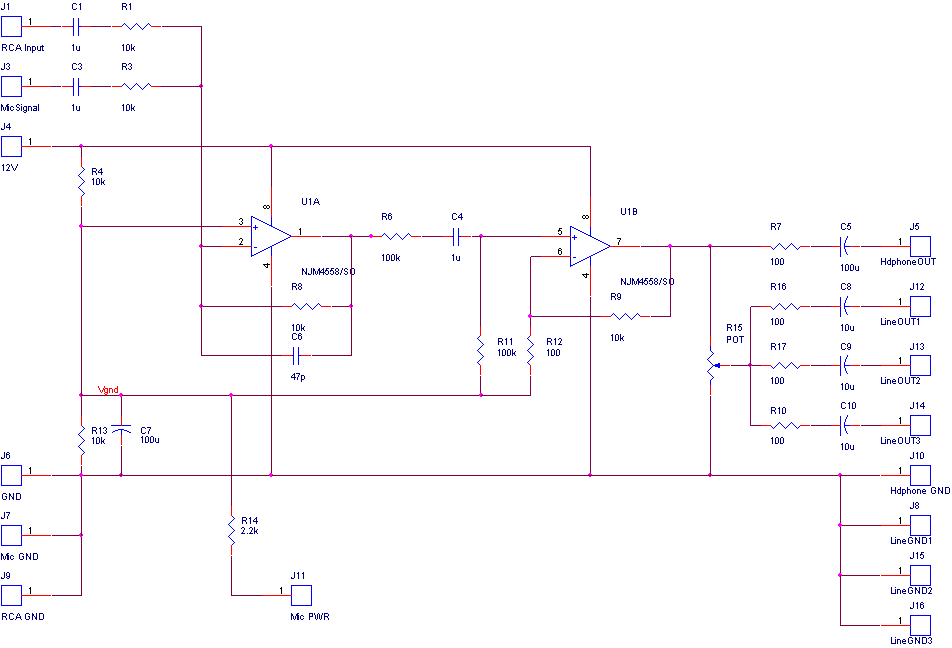

This is the circuit I came up with for this project - I tested the headphone output with the NJM4558 amp, and it works even though I thought it wouldn't from the info in the datasheet.
Let me know if anything looks fishy - all comments and criticism welcome/needed. Thanks!

The NJ4558 will not drive 8 ohm headphones well in this project because its max output current is too low and the 100 ohms output resistor will severely limit the output level.
The mic will not work without a preamp. The value of the 2.2k resistor that powers the mic is too low. Use 4.7k to 10k.
The mic will not work without a preamp. The resistor that powers the mic must be 4.7k or 10k.
The circuit will not be very loud with 8 ohm to 32 ohm headphones because the opamp cannot supply enough current and the 100 ohm resistors limit the output level.
