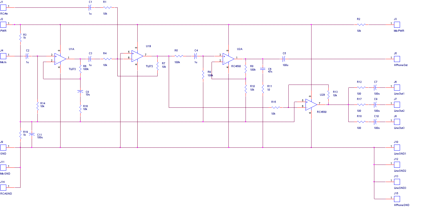

The mic will not work without a preamp. The resistor that powers the mic must be 4.7k or 10k.
The circuit will not be very loud with 8 ohm to 32 ohm headphones because the opamp cannot supply enough current and the 100 ohm resistors limit the output level.
Points taken - I've updated the schematics and tested it, and the performance is much better. Thanks very much for all the help!
I did have a couple lingering questions - do I need a resistor at the output of the amp going to the headphones? I read that I might need one to prevent a short from frying the op amp when the headphone jack is inserted - in this case the short would just discharge the 100µF (C5) cap to ground.
Also, I put in a 47nF (C6) cap in series with a 10Ω (R11) resistor at the output of the op amp going to the headphones because I saw it in an example circuit. Anyone know what the purpose of this is? Thanks!
The RC4580 opamp is more powerful than the other opamp but it also cannot drive 8 ohms headphones. What is the impedance of each ear of your headphones? Many headphones are 32 ohms and some are 600 ohms.
The resistor reduces the power from a power amplifier to headphones. Your RC4580 opamp does not have much power. A resistor is used in series with the output of an opamp that drives a capacitive load like a shielded cable (like the resistors to your line outputs) to keep it from oscillating.
If your output jack causes a short then use a better jack.
The RC4580 opamp does not have output current limiting so it will fry if its output load is too low (like 8 ohms) or shorted.
They are guaranteed to fry your RC4580 opamp, get rid of them.
They are used at the output of most power amps to present a low impedance load at high frequencies when the impedance of a speaker is high due to inductance. Power amps oscillate without the resistor and capacitor. Opamps do not have enough output current to drive such a low resistance.
You have R2 feeding all the noise from the power supply directly to the mic input. R2 should have a 1k resistor in series and a 100uF capacitor to ground as a filter to it.
R7 does nothing and can be replaced with a piece of wire.
