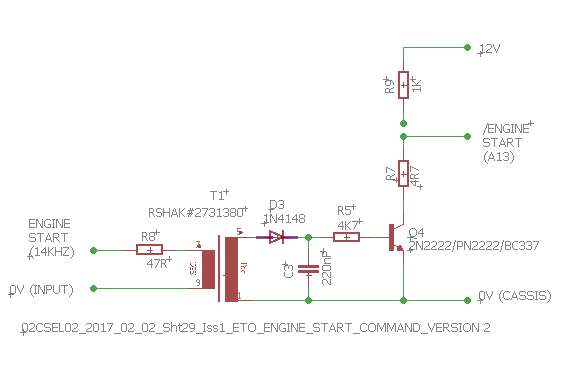

POST Issue 06 of 2017_02_02
Hi CBB9,
Below is the schematic for Version 2 of the Start Command Circuit which should do the job.
spec
ERRATA
(1) Connect a 100K resistor across C3
NOTES
(1) Hopefully, this is a practical circuit and will produce a /START COMMAND of around 0.2V.
(2) The circuit still does not use the 12V power rail.
(3) R8 is notional and will need to be adjusted for satisfactory operation. Increasing the value of R8 will decrease the sensitivity.
(4) Schottky diodes are not required
(5) A MOSFET is not required.
(6) R9 is for testing only
(7) In case anyone is wondering, the transformer is shown connected the correct way around (input to secondary)
(8) The transformer is not optimum but is a RadioShack type.
(9) The input and output are totally isolated, which is a good thing.

You Rock! I'll try to get to Radio Shack tomorrow night. For note #1, is that supposed to be 0.2A?
Baby boy due any day now, so if I disappear for a bit you know why!
In the meantime I just completed this circuit with what I had on hand. It's not ideal as it relies on a power supply, but it does meet the need for those who don't care. I used a 2N3904 in place of the BC547.
Hope all goes well with the new miniature CBB9.:)
No, note #(1) in post #54 is correct. The engine /start command is a switch to 0V and when made the switch will be conducting 0.01A as stated in your post #7
Q1 in the circuit of post #54 acts as a switch but when it turns on, by current flowing into its base, it will have 0.2V between its emitter and collector, unlike a true switch or NMOSFET, which will, essentially, have 0V across them when switched on.
The, 0.2V is just a characteristic of the 2N2222 BJT. It would be higher for a BC546/7/8/9.
I would not think that the engine management system will be concerned about the odd 0.2V and should still recognize that as a valid '/START ' command (/ means not or low voltage)
