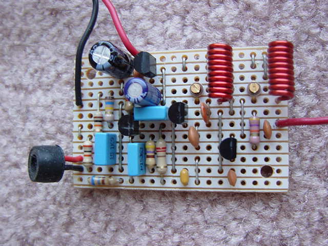

Hi Antey,
I made mine with Veroboard (with strips of printed copper) and its antenna is just a piece of wire 30 inches long hanging down. I will probably use a telescopic whip antenna from an old RC car transmitter. My Veroboard layout for mod-4 looks like this:
THANK YOU :D
But... I'm afraid to ask :) - do You happen to have a schema for board mod.3 ? Or maybe just suggestions about putting all pieces together - especially about making connections and wiring ? I am not expirenced enough, but I know that there can be some issues regarding additional capacities/inductances...

Hi Antey,
We are friends so ask what you want. :lol:
It is difficult making a very high frequency radio transmitter without having a printed circuit board and detailed instructions. Perhaps it is best for you to learn by making a kit that comes with all special parts, a printed circuit board and detailed instructions. :lol:
Layout at 100MHZ isnt extremely critical, like in the GHZ region. Just make sure that you keep your leads real nice and short and you should be fine. And try to place the components as close together as possible on the veroboard.
