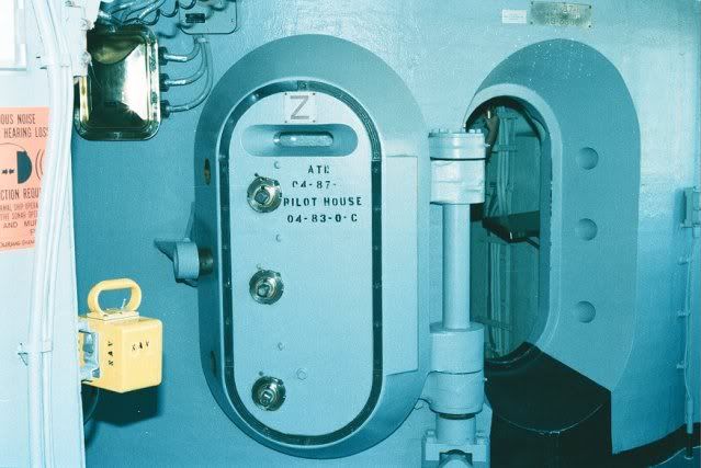

Back in the 1980s I was part of the huge effort to reactivate/modernize the old Battleships and upgrade some of the systems to modern computers but the 16inch guns were still using the old analog system. Working on those ships was the coolest thing ever. Try cutting holes for running network cable through walls that are 17 inches thick.
https://i229.photobucket.com/albums/ee178/PolarisBrian/Battleships/016284.jpg
