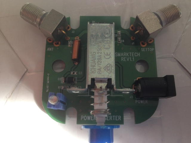

I have had some more thoughts on the power inserter. It is not as simple as just inserting the 12 volt power. A normal satellite receiver switches between horizontal and vertical polorisation by changing the LNB voltage from about 13 volts to about 18 volts. It also switches between two local oscillator frequencies in the LNB by inserting a 22 Khz signal into the coax to the LNB. The 22 Khz could be passed though the power inserter but it would require an extra filter in the power feed to prevent the 22 Khz signal being shorted out. The polorisation control would require extra circuitry to convert the change from 13 to 18 volts from the receiver to some other signal to be sent to the dish control unit. So my suggestion of using a masthead amplifier power inserter would not work.

Just an ... ... 'and finally .. ... '
I managed to get my hands on an OEM Power Inserter .. .. .. .so like all good inquisitive little sods, I took the back off for a looksee !
I suspect this will make more sense to some of you guys than it did to me, but the bottom line is it all works now !
Thanks for your help Guys .. .. ..
