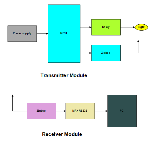

I just wanted to confirm my basic understanding about project. I have made diagram for automatic street light control system .
Am I missing something in block diagram ?
the Zigbee has IO pins that can connect direct to relay;
also instead of the maxrs232 chip, how bout a zigbee-to- usb chip
Yes agree.
BUT
You need to think about having "smarts" inside each light.
Who decides when the lights come on? The PC decides or each light turns when it is dark at that spot?
If every thought is in the PC then the light can be very dumb.
If each light can think then the PC is just a data logger.
