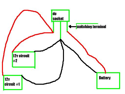

Would it be possible for that dc jack to power 2 different circuits? Both use 12v so it would sort of be like running them in parallel, if possible? I've have illustrated my very probably stupid idea with my unbelievable paint skills. (see attched file). Thanks.
Yes, that would work...:)
Wow... I wasn't expecting that :D I suppose the current for each circuit would add up. So say if circuit #1 drew 2 amps and circuit #2 drew 1 amp I'd need at least a 3A 12A AC-DC adapter?
Yes, and some headroom would be nice. Depending on what the circuits are, they could use more current on start up than in opperation....
