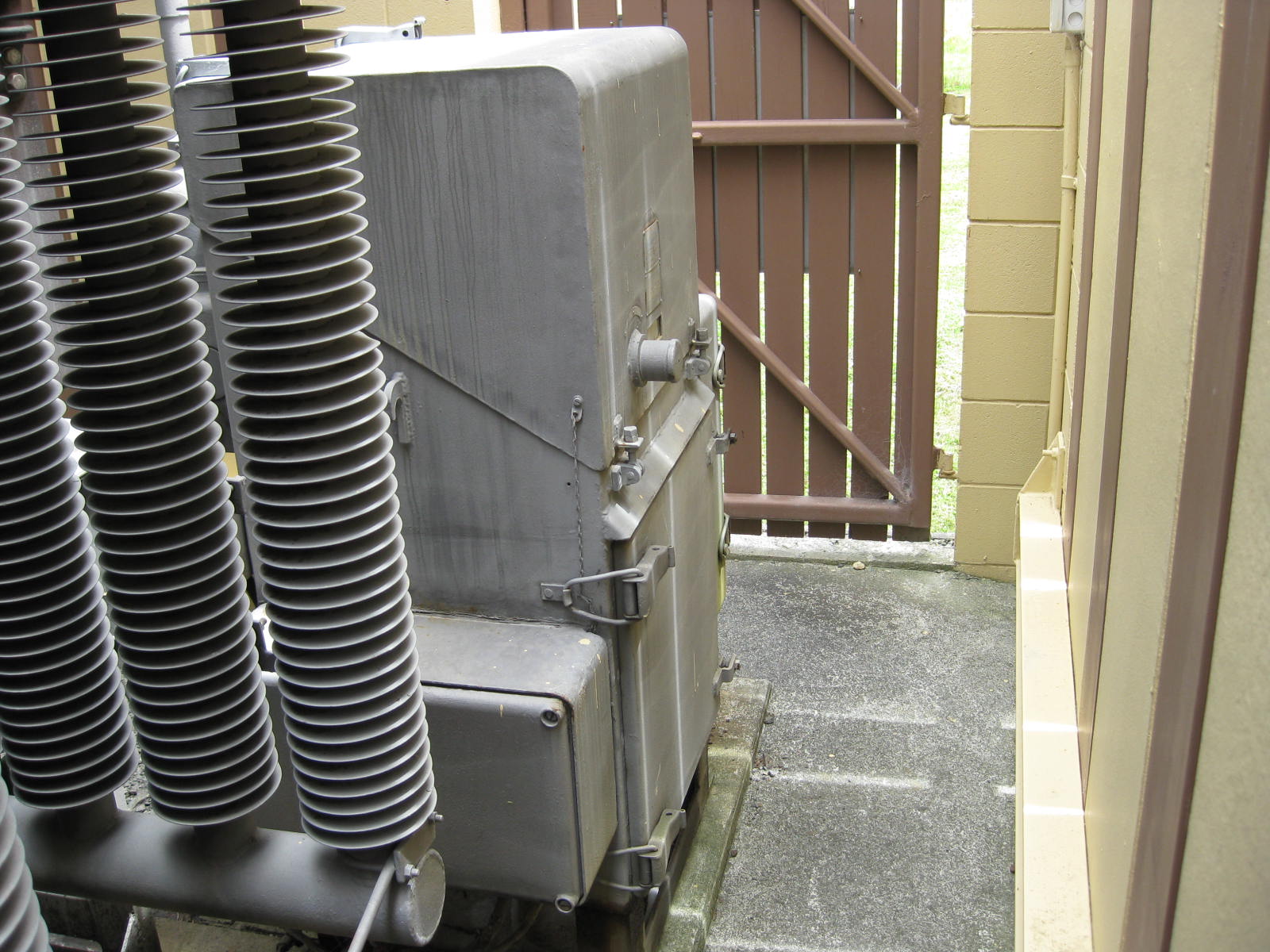

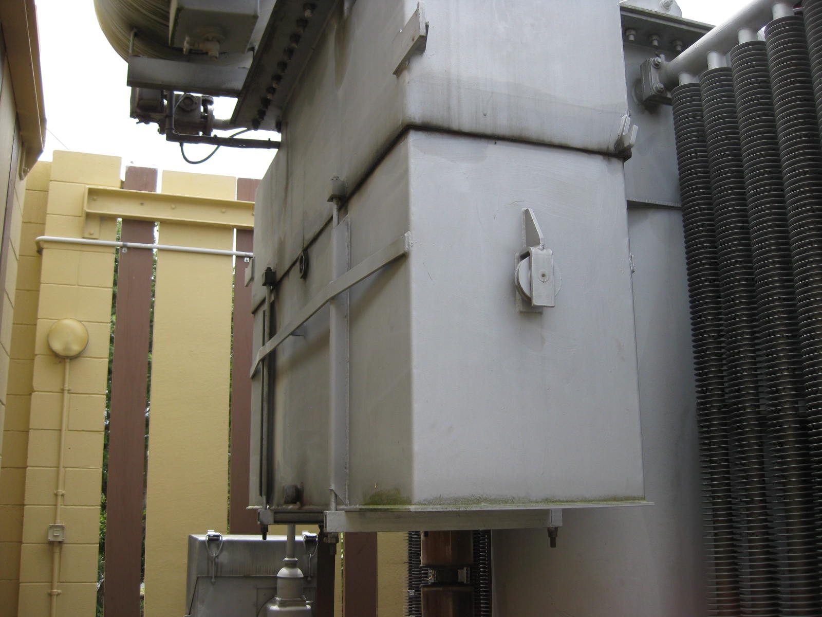

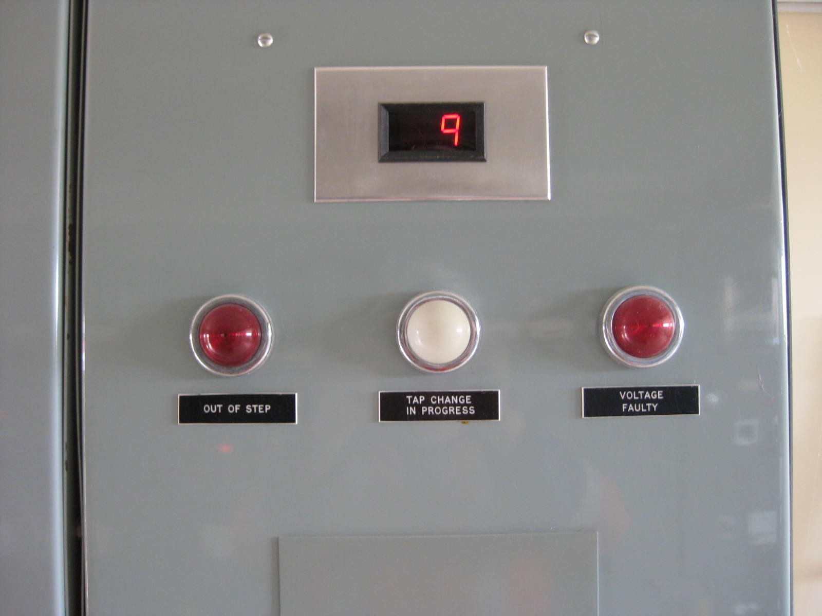

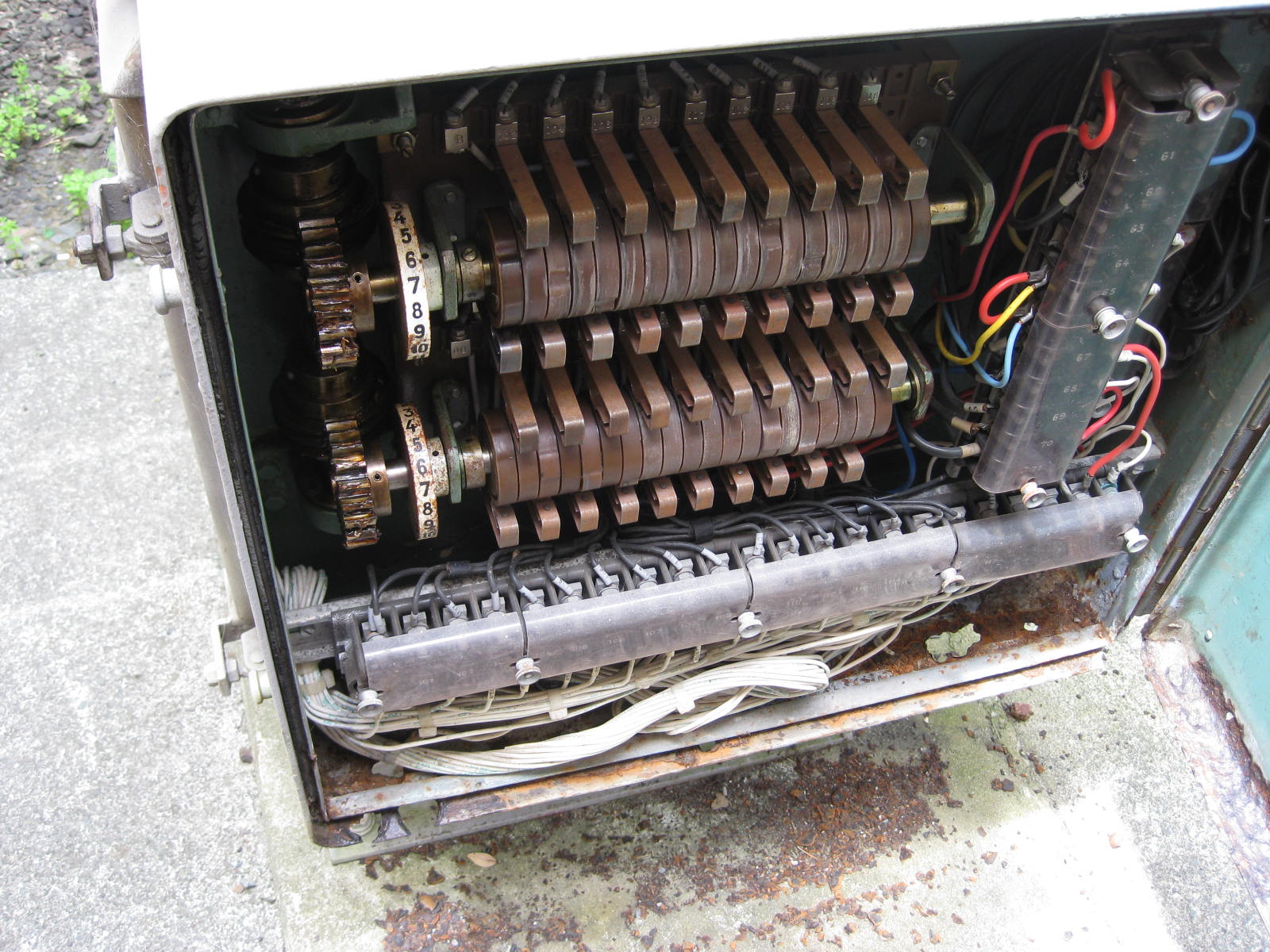

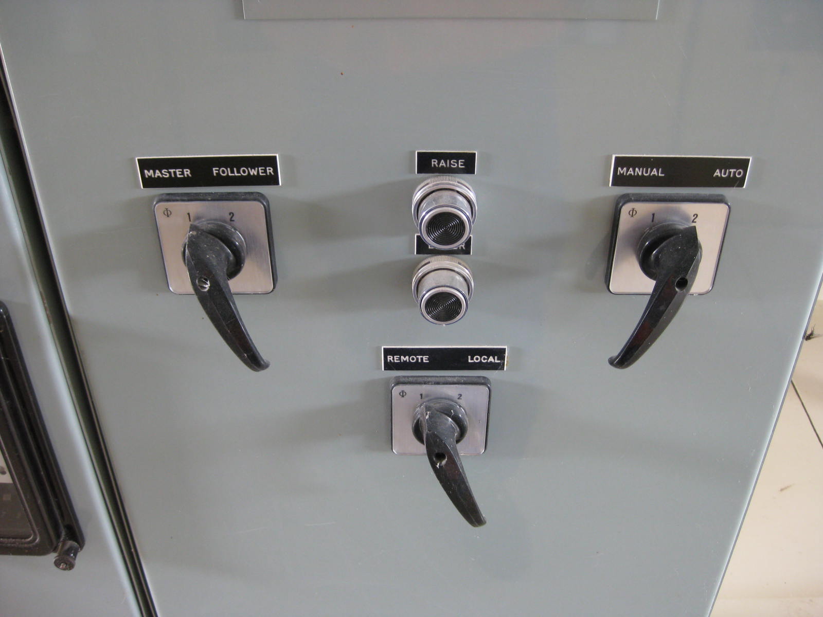

Tapchanger
I was in one of the older 33/11 kV subs and took a few photo's of a TCOL

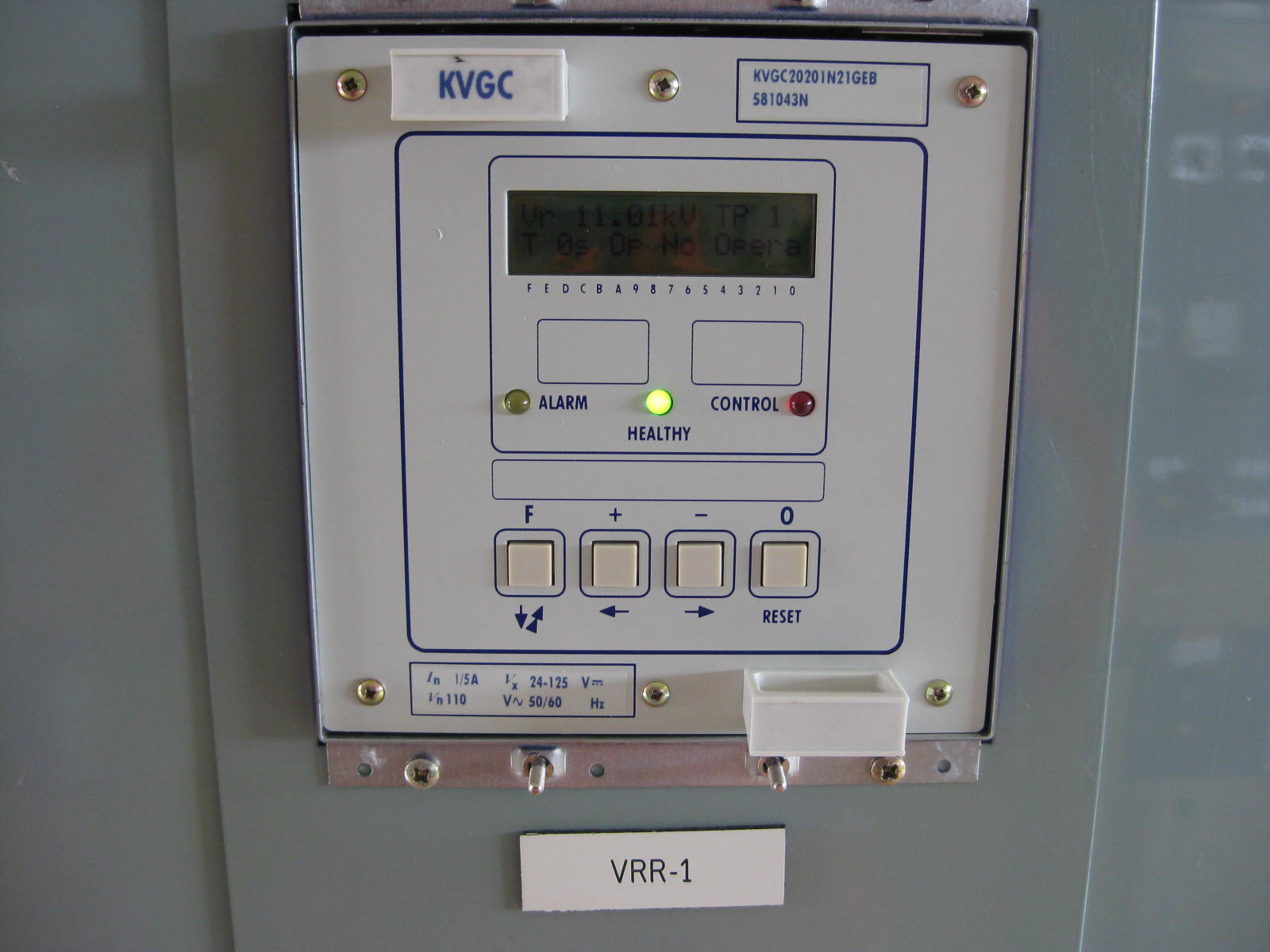

We use a lot of the Alstom KVGC voltage relays.
This is on an ASEA transformer 7.5 MVA
The open box shows the contact drums for the control circuits.
The cubicle on the ground has the drive motor and flywheel in it.
The big box bolted on the TX houses the actual tapchanger.
I have a video on my YouTube channel which showes a TCOL mechanism with flywheel in operation.

Correct.
In the KVGC relays that is programmed in.
Usually set at 45 seconds top avoid unnecessary switching for minor voltage dips
