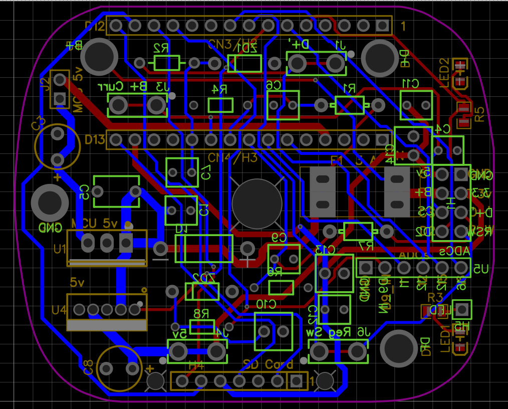

Can you show both PCBs and the schematic, as they all are now?
This is the power electronics schematic, wired point-to-point:
This is the controller board schematic with current patches:
EDIT: I also have a jumper from the "Regulator switch control" line to the "Spare LED" if that makes any difference. I accidentally picked a pretty high powered LED.
and the controller board PCB:
Definitely get rid of C1 on the gate of the FET - power FETs have massive gate capacitance to start with, and trying to direct-drive it from an MCU pin may be overloading it and causing glitches in itself; it needs either a series resistor to restrict the pin current to a safe level, or a power driver of some sort adding.
I also think you need to do some work on the PCB still; the ground planes are broken in islands due to so many long tracks on both sides, so not having much effect.
Quite a few of the topside tracks could be reduced or eliminated by some slight re-arrangements, and the power tracks made significantly wider.
The IRL40B209 does claim to be "Optimized for Logic Level Drive", so I didn't think I'd need a power driver. [They don't say if that means TTL or 3.3 V or what.] Ciss, Input Capacitance is specified as 15140 pF. What would be a reasonable value for the series resistor? I'm thinking I want a fast switching time to minimize heating.
I didn't think it would be critical, and since this is just a prototype... Would it make sense to make the top plane 3.3 V instead of GND? I have started working on a next rev.: https://oshwlab.com/carlk3/volt-reg-controller-board-2
(I have to go out now, I'll try and give some more details later).
Do you think that is the reason for the glitches I'm seeing on the 3.3 V power line? I tried to use my signal generator to recreate the problem on the bench, but has nowhere near enough drive. I tried putting a -10V 15ns pulse on DF. It turns into -160 mV rebounding to about +100 mV. I can see a slight echo of that on the 3.3 V power line, at around + 60 mV, -16 mV.
Next steps: I'll rework the gate drive of the IRL40B209 by removing C1 and adding a 1K series resistor. I'll tack on some test points here and there, then put the thing back on the car for a long probing session to see if I can trace back the source of the glitch. I'm pretty sure it's coming from DF, but I can't see how it gets from there to B+ and ultimately 3.3 V.

Are you driving the field FET using slow on/off switching, or using PWM?
The outputs on the MCU appear to be rated at 20mA, so you can safely go down to 270 or 220 Ohms, to minimise the FET switching time. That is still very slow due to the high gate capacitance.
It would need a separate gate driver to be able to use PWM at even tens of Hz; I'd not try above 1Hz without that.
If you are re-doing the PCB, try to aim for the ground plane on the top side and minimise the lengths of tracks that interrupt that copper area, so it's as near continuous as possible; plus using as wide tracks as practical for all power interconnections.
I started changing a few bits in the previous version, but I did not get very far; I'm not struck on that web editor - I use the downloaded program. I also did not want to re-arrange components in any significant way as I was not sure of the reasoning for the locations.
Currently, it is switched on and off as required with respect to voltage, current, and power limits. The fastest it could try to switch with the current firmware is 100 Hz. I don't think that would happen very often, but I might need to put in something to guard against that. Of course, I could easily change the cycle time to 10 Hz or something; it is just a constant in the firmware. I could even make it configurable. Would PWM be better?
What I currently have on the next rev. (https://oshwlab.com/carlk3/volt-reg-controller-board-2) is GND on top and 3.3 V on the bottom. That seems to work well for routing.
Thanks. I will look at making the changes in the next rev. (I have only done a quick auto-route so far since the schematic is not frozen yet.)
The main constraints on the component positioning are the size of the MCU board, the SD card socket, and the fuse (and, of course, the locations of the holes).
