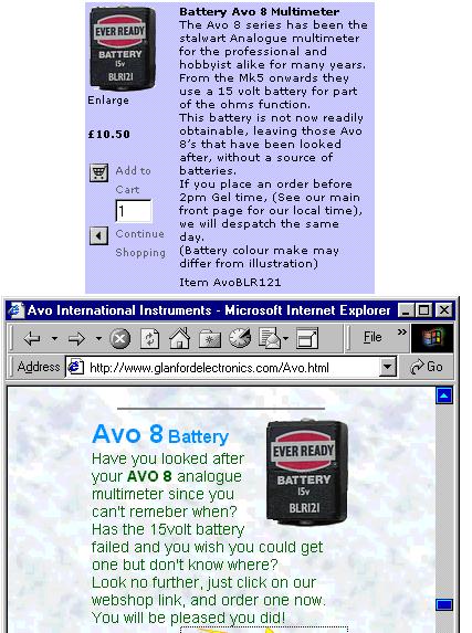

The resistance battery in my Avo has gone flat.
I think i left it unattended with the leads touching,
on resistance.
The battery has gone flat.
Its been low for a while,
now its un-useable.
Any suggestions ?
John
OK, I give up. I'm assuming AVO means the same thing VOM means. What the heck is the "eight" about? Oh - replace the battery or recharge it. I'll bet you knew that. What's up?
Hi Ron,
No, Avo doesn't mean VOM, i don't know what VOM means.
I have attached a little info about Avo meters,
which are well known in the trade.
(or so i thought)
These jerks think i'm happy to pay over ten pounds
sterling for a little 15v battery, they have another
think coming.
Ive been looking at little 12v batteries that are
available for £1-79p each from
https://www.smallbattery.company.org.uk/
But i don't know if i can alter the innards to use it.
Also i might see if i can put a 'time-out' on the
battery function somehow.
Surely someone has dealt with the 'Avo battery'
problem before now ??
John :)
