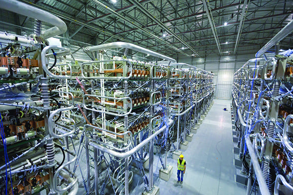

apparently there are undersea power cables from the Continent to the UK, and these have to be DC because they are under sea water?.
I think that the idea is to reduce the capacitive current to earth.
There are some high voltage, long distance overhead power lines which use DC for the same reasons.

I asked further, and apparently there are undersea power cables from the Continent to the UK, and these have to be DC because they are under sea water?
Yes exactly. AC cables have limitations when it comes to length because of extreme power factors over long distances, and DC cables is usually a better choice.
Another thing about long distances DC cables in sea bottom is that you need only one conductor, the sea water itself works as a huge earth conductor. Not without any losses of course - in each end of such cables there is huge underwater electrodes, and when running full capacity it may look like the sea just outside land/beach are boiling.
What happens to anything lving in the vacinity?
