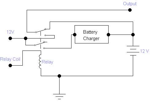

Hello,
I'm looking for a simple circuit that does then next:
- when 12 V applied in the input connect the input to a battery charger and the same voltage to the output.
- when no voltage applied in the input, connect the output to the battery charged in the first stage.
Any ideas. Where to begin?

Here's a circuit that should do what you want using a DPDT relay. This assumes that you can leave the battery connected to the charger output (which should not be a problem).

ronv, crutschow: Thank you for your answers. I think it is a very usefull solution. Why to use a DPDT relay and not to use a DPST? For a 150 W Input Power Supply is a very big relay? I have a little limitation in space...
rogs: I don't understand very well the diode configuration you are explaining. Could you attach me a simple "crockis". My battery is a LiPo battery and is charged in diferent stages with a controller. Is this a problem?
Thank you
Quank
If you look at my schematic you will see that a DPST relay will not work.
For a 150W @ 12V you will need a relay with contacts rated for 15A DC .
Thank you
The simple 'diode mix' idea I was suggesting is only really suitable where you can set the primary supply to act as both a power source, and a constant voltage charge source for an SLA battery. The concept is not really suitable for LiPo batteries I'm afraid!
Okey, I'm gonna use a relay a DPDT relay. Is there any way to make a "no interruption" output supply when making the transition from "ALIMENTATION OFF" (backup is giving supply and is not fully discharged) to "ALIMENTATION ON" (charging battery)?
Maybe to put a diode network on the output?
