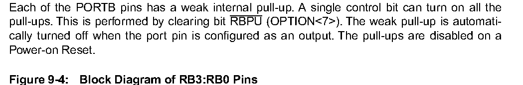

I dropped an 8 position switch on a board (port B), figured no pull-ups as I saw weak pullups.
Weak pull-ups are for output only (as I now read). I have all the pins grounded on the other side of the switch.. Any quick fix other than soldering resistors to 8 pins.

The pullups on PORTB are for input only, the Firefly uses them for it's switches and they work fine. Sounds like you drove the wee PICs I/O to gnd.
https://ww1.microchip.com/downloads/en/DeviceDoc/31009a.pdf I/O ports
The ICD2 should be real hard to kill, assuming you're not using the mclr, PGC & PGD for anything except the ICD2.

I wanted to use the weak pullups on port B (input wise). But the PIC never saw high when I flipped the switches to open. I pulled the PDF from microchip and it made it look like they were for output only.. I was in a rush and did not want to read, posted here.. And went to solder them in.
But I would like to use them on the pic chip in the future (for input). If they work for input. Will read it tomorrow as it is late.
