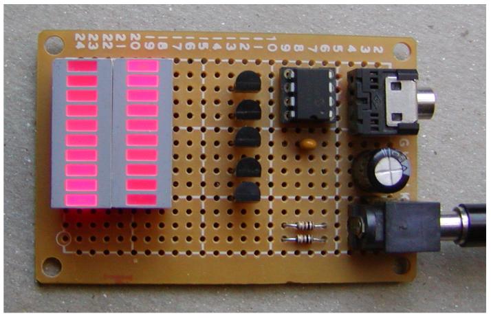

If you've got more time than money (like me) you'll find you can do a pretty good job using an exacto knife.
pwm-64-jpg.37264
This, above, would be the kind of end result I'd be looking for... like my 'thing', I'd have a power jack, a PIC, some transistors and some resistors visible from the bottom, but I'd still be able to say to the person I make it for - "it has a proper barrel jack for you to plug your wall wart power supply into" and not have a) me soldering wires with heatshrink over them directly to the veroboard and b) them having to trail the item and the wire around in one unit, which I'm sure must add stresses to everything - so much better to be detachable.
This, above, is very nice!
So, you've just cut out the holes in the veroboard so they're a little bit bigger, have you, then rammed the paddles attached to the barrel jack through them and have soldered in the other side so that it's all nice and firm and rigid, or do you use glue as well or what?
I really don't mind them seeing some of the 'gubbins', as then they know that I really made it and it has that homemade look... as I say, it's just where power is concerned that I'd like it a bit more professional looking than me soldering wires directly.

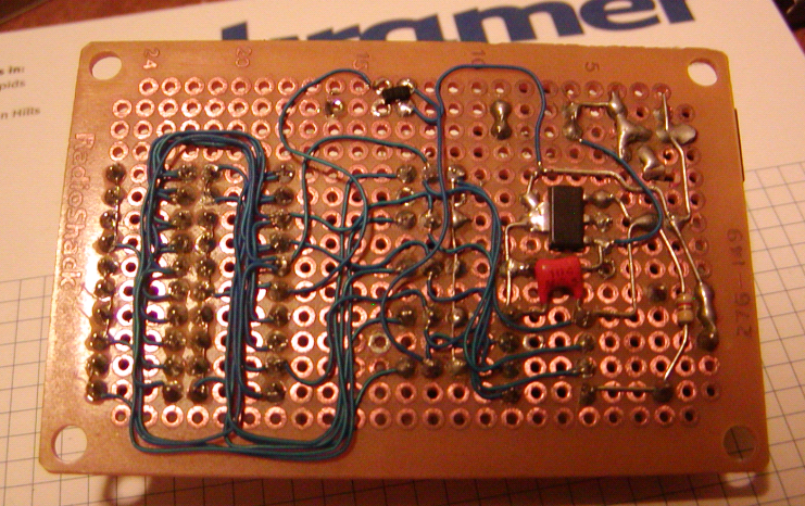

Actually Hippo' I use the exacto knife to cut slots in the board. It takes about 30 minutes. Then I insert the connector, fold over the legs, and solder them to several pads. I don't use glue and they're quite solid and rigid. I've attached a picture of the bottom side of that board for you...
Thanks. I think I shall try to emulate this, then, as it is the kind of end result that I'm looking for. It might take me a while - I'm still waiting for my gear to arrive and who knows when I will ever see the postie again - but I'll post pictures if I'm successful.
