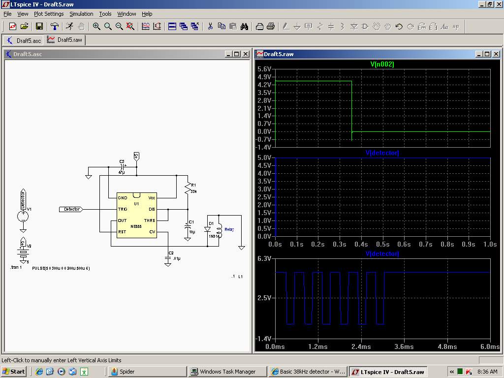

hi all, i'm the original OP, for some reason i stopped getting email alerts for replies to the topic.
anyway, yes, all i really want to do is trigger a relay. my old camera had an IR receiver built in, and so i have a little remote to trigger it. the new camera i bought does not have an IR receiver, but does have an input plug on it where, when a circuit is completed over it (hence the relay) the camera takes the shot.
so, in all actually, it want to use this same remote, to power a relay, which will complete an arbitrary circuit. i do not want to decode the IR signal or anything. like someone else said: IR pulse present -> trigger. the whole interface between said circuit and camera i have taken care of from my side, all i need help with is the IR communication with the relay.
is that clear? where do i go from here?

Maybe I'm missing something but this is what I think you want.
Most detectors are active low, meaning when they get a signal they go from +5 to 0 volts. If I understand you right you want to click a key on the remote (any key will do) and have the flash trigger. If so, the circuit below should work. It should be a small relay - I think radio shack has 5 volt reed relays so the ic can drive it. The series of pulses from the remote triggers the one shot which closes the relay, flashing the camera. The trace on top is the output of the one shot (about 1/3 of a second) to simulate the button push on the camera.
i seem to be getting a lot of contradictory replies (thank you for all of them!) but this seems promising. i'm a bit confused about attaching the detector though, mine has three leads (+5V, ground, and signal) yet the diagram only shows one. also, is the shape at the very top middle with the +5, does that mean the input voltage +5V?

The datasheet from the manufacturer of the IR receiver you have shows its pins on a photo, how to connect it and its details.
But if you bought it at a ripoff price from RadioShack then even they don't know anything about it and don't even know who made it.
thank you very much!
I just drew the output of your detector. You still need your 5 volt regulator and voltage and ground to your sensor. Keep in mind your sensor may be bad now if you hooked it to 9 volts. The +5 in the center of the schematic is power from your 5 volt regulator to power the IC.
Here is a spec sheet on how these sensors work. They have several advantages over just a photo diode in that they reject ambient light, and have automatic gain control which gives them their range.
https://www.electro-tech-online.com/custompdfs/2010/12/TSOP4840.pdf
You might want to add the little filter (100 ohm and .1 ufd. cap) to your sensor. (Page 1 app circuit)
Page 2 shows the active low output.
