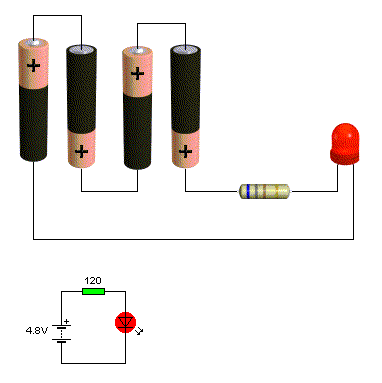

Easy, just connect each LED in series with an appropriate resistor and connect them all to some batteries via a switch.
Use the following formula to calculate the required series resistor value:
[latex] R = \frac {V-Vf}{If}[/latex]
For example, the blue and which LEDs will have a typical forward voltage drop of 3.5V, a forward current of 10mA to both prolong the life of the batteries and the LEDs and four NiMH AA batteries in series, a total voltage of 4.8V.
V = 4.8V
Vf = 3.5V
If = 10mA = 0.01A
[latex] R = \frac{V-Vf}{If} = \frac{4.8-3.5}{0.01} = \frac{1.3}{0.01} =130 \Omega [/latex]
As the LEDs will be fine with a bit more than 10mA, you can easily use 120Ω, the nearest E12 standard value.

Here's a circuit showing two LEDs wired up to a battery, for 20, you just need to add 18 more resistors and LEDs wired up as shown below.
Hero,
Thanks for the diagram - thats exactly what I needed - only issus is Im horrible at the math on these things... any help on the voltage/number of batteries and the size resistors to use? I was hoping to use a 9 volt batt due to it general size... also using white/blue... can they all be in the same parallel circuit with the same resistor size on each LED?
You could use a 9V battery but I wouldn't recommend it because it won't last as long as four AA cells or even AAA cells. It's not just about voltage but the Ah rating of the battery (Google it if you don't know what Ah is) and a typical 9V battery has a lower Ah rating than an AAA cell.
