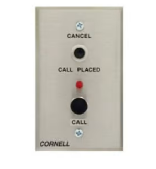

Each room has a small panel that has only mechanical switches, no circuit boards. (only has a few resistors or something that keeps the "call placed" led on until the call is cancelled).
Has a momentary switch for placing a call, and a momentary switch for cancelling the call.
Cancelling the call at the room turns off the LED for that room and audible beep at the control panel
If there are other rooms that placed calls at the same time, the LEDs for that room will stay lit at the control panel until each room call is cancelled inside the room, and audible beep will stay on until all rooms are cancelled.
Five wires can support this wall plate. The ground wire feeds the switches and LED ( through a resistor), the power wire feeds both switches and LED, and the three wires are commonly connected to all wallplate switches and LEDs. Pressing any button could trigger an RC timer to wait for the controller I.C. to make its rounds, stop the count and display the inputted room number.
