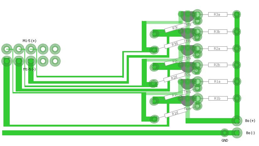

I assume there are no problems with my finalised schematic, so I've been planning the PCB layout (also using powerpoint :eek:) and it's becoming quite complicated... looks like it may be pretty tricky, especially for my first PCB!
Any tips on how to design / produce the PCB?
CAD software is better at making PCBs than PowerPoint.
Heck I should talk, I've used OpenOffice.org Draw to make PCBs, it's hard work but still better than PowerPoint.
I used Altium Desinger (formally Protel) at work and it's great but very expensive. Others here use Eagal or FreePCB, there may be others. I've dabbled with Eagal but never took to it and having Altium Designer at work meant I never needed it. Now I no longer have Altium Designer, I might give FreePCB ago.
I've tried Eagle, but I've found its components libraries extremely difficult to navigate. I gave up trying to make schematics, let alone PCB designs...

I'll post the footprints I use if you like but I don't know how we'll they'll convert to .EMF or Power Point.
I definitely think it's worth learning a PCB CAD package. I didn't get on with Eagle either, may be I'll give it another go now. What about FreePCB have you tried that? I haven't and I'm willing to give it a go.
I haven't tried FreePCB, I'll probably download it tomorrow morning (well, later this morning actually) and see if it's any good.

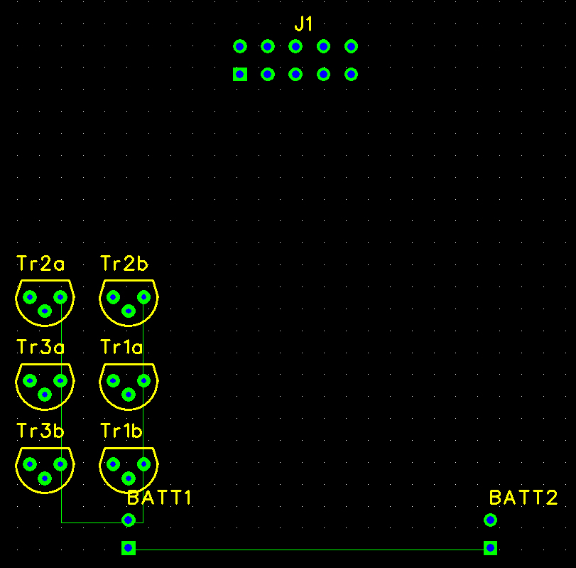

I started the PCB design again using FreePCB instead of powerpoint now, but the range of resistors is slightly confusing, and I'm not sure if I'm drawing the copper tracks correctly. I'm having to use "draw copper area" and make a areas which just consist of lines.
I also can't adjust the width of the resistors, so I can't set a more convenient distance apart to put the pads at either end of the resistor either.
I haven't gotten very far with the PCB layout design in either FreePCB or Powerpoint, but attached are screenshots of both incomplete designs; looks like the end result is going to end up quite complicated. I confused the collector and emitter terminals on the powerpoint design so the left and centre pin connections should be swapped. The grid on the FreePCB image is 2mm²
