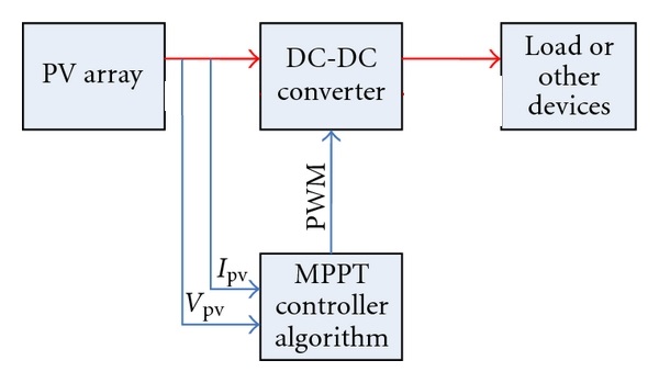

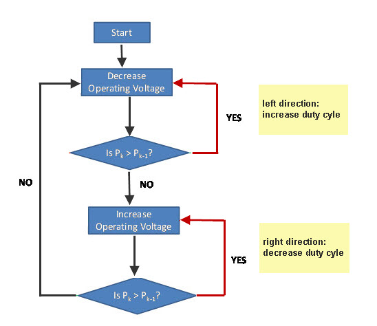

What microcontroller should I use to design a maximum power tracker? I have some experience with 8051 as is witnessed by this thread but have forgotten almost all the stuff. I was thinking of using PIC 16F877 but after reading Jon Wilder post above, I thought it would be a good idea to explore an alternative. I want to base the code on this flowchart. The block diagram of the system looks like this. You might also find this block diagram useful. Thank you.

I have found this code which I believe can be tweaked to serve the purpose. Please note that I don't really understand the code and it has been few years when I did some basic C++. Please let me know what you think of it. You can also refer to post #22 above. Thanks.

Well thats pic 16f code and your in the 8051 forum! so are you using a pic or a 8051? you are going to confuse me
Hi Little Ghostman
I'm going to use PIC. I posted it here because I had already made a related post above. Sorry for the confusion. Thanks.
Which pic? The one mentioned above? do you have the CCS compiler? Do you have a schematic? Are you going to make me ask 1000 questions first? lol :D

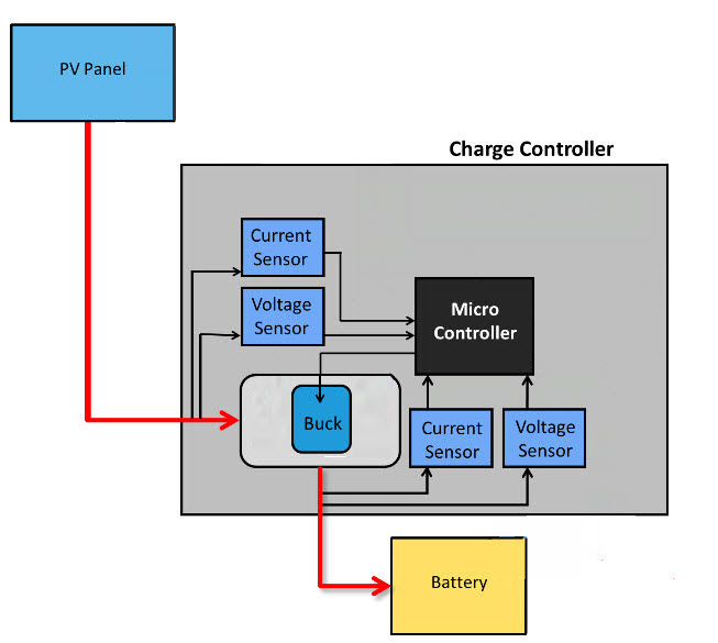

I can use the one mentioned in the code, i.e. PIC 16f876. This is the block diagram. You can also refer to post #22 above. Let me know if there is still some confusion. I can also get CCS compiler. Thank you.
I dont use CCS, but yes it would probably do what you want regarding the block diagram. If you go hat route your question's may be better answered on the CCS forum, most here dont seem to use CCS although it dosnt look much different to most C compilers.
Anyway to answer your question, yes its ok based on the details given ;)
