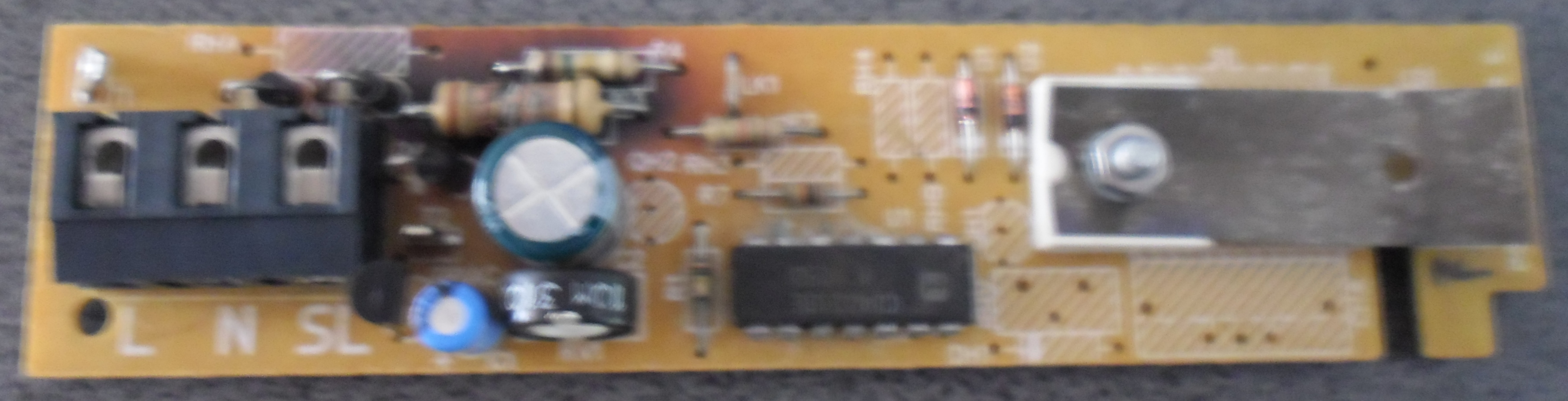

The pcb controlling the over-run of my bathroom fan has failed. I've removed it from the fan which runs fine with the light switch, but I would like to repair and replace the over-run circuit..
On examining the pcb I noted it was discoloured in the area close to resistor R3. I think this had a value of 2.2k but it was difficult to see if the bands were red or brown. I found the resistor to be open circuit and when I replaced it with a 2.2k resistor this glowed as soon as I applied 240v ac. What component of the board will have failed which is causing overall failure and specifically caused R3 to fry? Which component should I replace first?
I include a scan of the board - I tried to convert this into a circuit diagram but couldn't guarantee it would be accurate! - and a commentary on the components and the connections....

It would be much easier for you to draw a schematic that it is to try and work out what is going on from your notes. If it doesn't make sense at least we have your board scan and notes to compare against. Otherwise anyone trying to help has to work out a schematic from the information you've given, which is incomplete since we can't see which way around the triac is, which is pin 1 of the ic, or the orientation of the diodes, and the tracks are not terribly clear either, I can't tell where all of them go.

The circuit is shown in attachment jls1004.pdf; it's not conventionally drawn but the linkages and nodes are correct and I think it should be intelligible. I can't positively identify the value of some of the resistors because of discolouration - reds might be purple and vice versa and diodes D1 and D2 are unidentified but I think the polarity is correct. I've also included a rather fuzzy photo of the component side of the board; the soldered side was provided in the OP.

Ok, it's helpful to be familiar with at least the E12 series of values, that will help guide you towards the real values of some of those resistors. D1 and D2 are probably 1N4148. I'm not sure about the orientation of D3 and D5, looks like you've drawn them the wrong way.
It could be that R3 has simply failed - it looks like it should be dissipating a couple of watts. I would try putting in a 22K 3W one, then see if the circuit still doesn't work.

Two things I would add is a snubber for the triac ( an RC network). The large resistor that's popped should be of the metal oxide type and lifted off the board. Clamps should be added across the IC and add a varistor across the line. So, those parts will be optional.
Metal oxide resistors basically basically open when stressed and may actually totally break into two parts. They are also sold as fuseable or flameproof resistors.
There is a good chance that the IC is damaged and possibly the Triac and the popped resistor.

D1 could actually be a zener, it makes sense like that. So, you should check D1 for open or short, and C1 for short. I'm wondering if a 555 timer could be used for an alternate circuit, only 8 legs instead of 14!

The power for the IC and the triac gate come from a transformerless supply, using R3. R3 has 240 V across it for half of each mains cycle, when the diode is conducting. That gives about 1.3 W dissipated in the resistor, all the time, whether or not the fan is on.
Along with the fact that there isn't much cooling around the resistor, is why it gets so hot. It really needs a higher power resistor, or a circuit that actually shuts down.
Fans like that take as much standby power as most TVs!

I've replaced R3 with a 22k 5W and replaced the triac, but get only 5v at the output pins.
