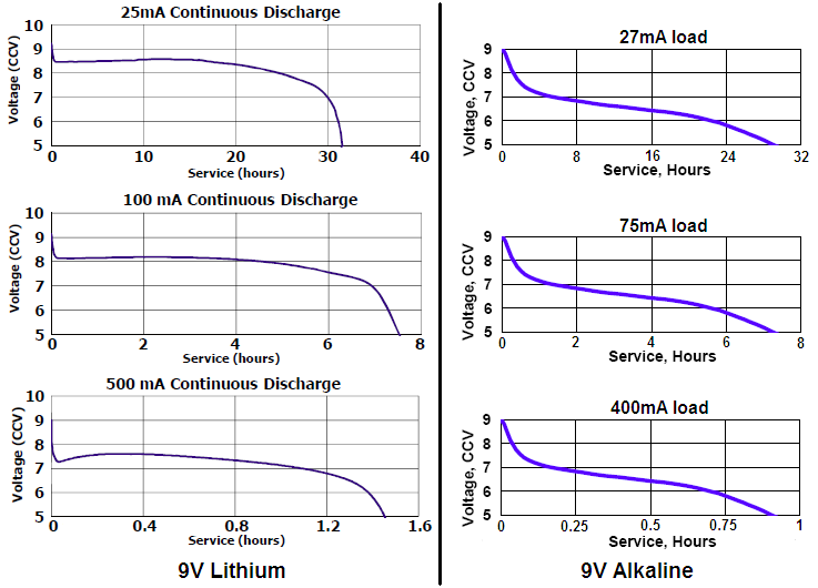

A 9V alkaline battery starts at 9V then quickly drops to about 7.2V, then drops slower until your circuit won't work anymore. A 9V lithium battery is much better as shown on my graph.
One single 2000mAh AA cell can be boosted up to 9V but then its current is more than 6 times higher so it will have much less capacity of a little 9V battery. Its voltage drops the same as the 9V alkaline battery but faster.
