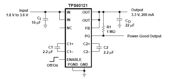

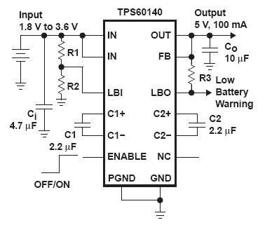

Since I posted this question I realized that I should use switching regulators with boost-up to minimize energy loss
I will try TPS60121 for 3.3V and TPS60140 for 5V
In this case I can use only 2 AA cells
I actually know my requiremens much closer now:
3.3V @ 160mA
5V @ 40mA
5V may go down to 3mA if I will eliminate LCD backlight and one LED
