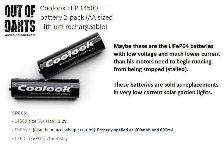

I plan to modify one of my flywheel Nerf blasters using AA sized LiFePo4 batteries from the OutOfDarts shop. The biggest roadblock is finding AA sized (or any that aren't Li-Po) batteries that have 10+ amps of discharge to meet the demands of the Honey Badger motors (22amps for a pair according to a modder). I've made the decision to not use Li-Po due to my concerns about it's safety/stability.
The low power LiFeP04 AA size batteries are too weak to power his high current motors:
Good quality protected 18650 cells are easy to find.
eg. A few seconds on google:
Use cell holders and a separate cell charger; that avoids the other common problems due to trying to incorporate charge circuits in a device.
To boost the available start-up current, you could connect a couple of these across the battery (assuming that is 4.2V max).
Each one gives an extra 8A peak current.
Do be aware that when the gun is firing, the motors will be under some load and the current rather higher than idle - and that must be within the battery continuous ratings.
