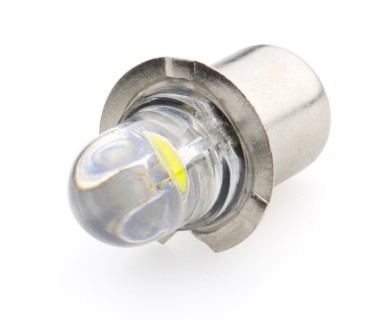

You want a LED replacement bulb. They use much less power. The ones I designed use a PWM. Most will work over a wide range of voltages. Many will have a spec of 2V to 30V or they will say 2 batteries to 5 batteries. (read the data!) Don't use a old type bulb.
Ron, where do I get the ones you designed and make sure I'm getting the right size replacements? Also, to insure there's enough power and that lights stay on the whole time, I would probably use 3 of those Lithium Thionyl Choride D size batteries in each unit, if that would work. PWM?...is that Pulse-width modulation?

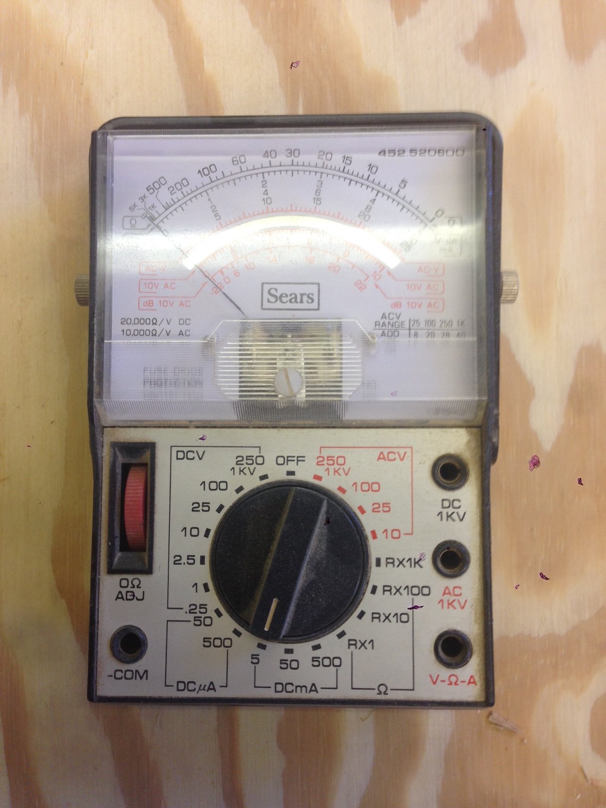

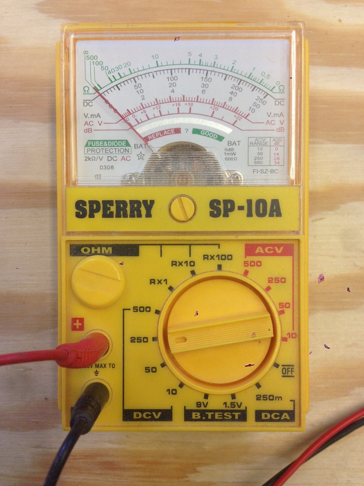

Next question: Do you have a Multimeter for measuring voltage/current? Brand/Model?
Mike, although it looks like the best thing for me to do is to go with Diver's LTC batteries and Ron's LED replacement bulbs...I just wanted to follow-up with you, since I said I would...attached are images of the Multimeters I have available to me (they're not great ones, but they have been very helpful around the shop, when problems arose).
i used to make LED bulbs like that. in a standard 2D flashlight, the battery life was about 6 weeks before the LED went to half brightness. actually, for white or blue LEDs you need 3 batteries.
Jed, the Mag-Lites in the boxes are 3 batteries each...I'm hoping that using 3 of the size D (LTC) batteries that Diver suggested earlier #17, they will stay lit for the entire 7 months.
i think you will find the "50,000 hours" is not how long a set of batteries lasts, but is the average MTBF (mean time before failure) of most LEDs, some of them i've seen rated as high ad 100,000 hours. the MTBF of a standard incandescent bulb is about 150-200 hours (less if you drop the flashlight while it's on). that's the reason i was able to make LED "bulbs" back in the 1990s like the one ronsimpson had a picture of, and make a bit of extra money selling LED sets to preppers. i still have a flashlight around here somewhere with a complete set. there were 3 IR bulbs, one red, one orange, one yellow, one green, one blue, and one white. the IR ones were for use with night vision goggles. the white one wasn't very bright, but you needed white for reading maps without missing important features (like "danger" areas, printed in red, which if you used the red or orange LED, you wouldn't see it on the map)

The LED bulbs I know use the 1 watt or 3 watt LEDs. (other power levels available)
Most have heat sinking that tries to dump that heat into the walls of the flashlight.
Most use the LEDs at near their rated power. 75% to 90% depending on design
Some high end LED bulbs watch the LED temperature. One uses 1.5 watts until the LED gets hot then backs down the power to keep the part at a good temp.
It is typical that a 1 watt bulb pulls about 1 watt from the battery and delivers about 0.9 watts to the LED. If the bulb is operated within its voltage range; then the battery current will be what ever it takes to get 1 watt.
The PWM changes power to power. (battery voltage X battery current) = (LED voltage 3V X LED current 0.33amps)
...LED is probably not operated at full power
...PWM is 80 to 95% efficient. Most efficient at higher voltages.
