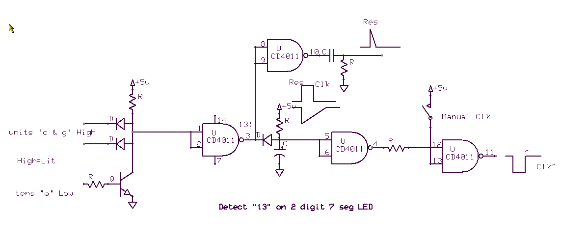

Just did a quick check, a circuit as simple as this type would get the job done.

hi LC,
Nicely done Eric.
Only possible complaint is the duration of pressing manual push button. If someone presses it for a few seconds then the display will be zero.
Lengthening the RC time constant would result in the display displaying zero, then change into one few seconds later for a brief push of the button.
You just can't win in both cases. :)

hi LC,
The RESET signal is taken out before the manual CLOCK, so you could keep the manual CLOCK switch pressed for as long as you wish without creating a RESET.:)

hi LC,
I'm not talking about the reset. It works OK.
Let's consider the case when the count is "12". User press hard and the counter advance to "13" and immediately reset into "0" with no problem.
However, you have rely on the reset circuitry to generate an extra clock pulse to advance the counter into the "1" state. The current circuit won't work because the clock signal control is taken over by the push button as long as it is pressed.
However, it is not difficult to rectify with additional circuitry.
This "0" stage problem is difficult to get around with, unless we use presettable counter.

hi Eric sorry to but in another persons post again but i am trying to improve my circuit reading skills(not doing very well though),i wanted to ask what are the diodes in your diagram for?i mean it will send a high when the other side is grounded?rite
And why the RC circuit on the manual switch side i mean the signal wont go anyways if the switch is not pressed?

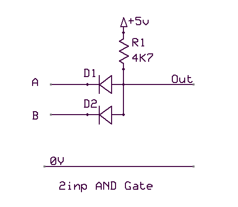

Hi eblc,A question to you also about the 'transistor and diode network' what will someone need them for?Decoding?
I know the above questions may sound stupid but it is better to ask them rather then not knowing them for later.Be Gentle!
The two diodes and the resistor up to +V form an AND gate, both inputs
[cathodes have to be high if the junction of the two anodes is able to go high].
The transistor input [base] has to be low so that AND gate can be enabled.
So, when 'c & g' are high and 'a' is low, pins 1 and 2 of the 4011 will be high.
Pin 3 will go low and the Cap discharged, the RESET pulse is via pins8/9 thru a differentiator C/R to the 40110 RESET pin.
This RESET will clear the inputs to pin 1/2 of the 4011 and the RESET pulse will disappear.[the diode AND gate will open]
As pin3 goes low, pins 5/6 also go low, so pin4 goes high and the clock pulse goes low on pin 11.
As the R/C on pins 5/6 charge towards +V, eventually pin4 will go low and pin 11 go high,, its this high edge which clocks the 40110.
The R/C delay isnt on the manual switch side.?
Its down 'stream' of the R/C and RESET.
Do you follow, if not please ask.
EDIT:
Added image of 2inp AND, using diodes and a resistor.
Both A and B have to be high in order for the Output to go high
