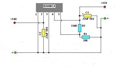

It's supposed to be a DC-to-DC step-down voltage converter, reducing 14V to 12V. As expected, my voltmeter measures Vin to GND(in) at about 17V. Not as expected, it measures Vout to GND(out) at about 0.03V. Whether or not the input voltage is applied, I still get 0.03V.

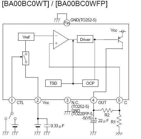

Attached are two pictures, what Rohm suggests and what I (think I) built. But they do not represent very well my inability to control the soldering iron, or the number of perf board holes whose copper-clad rims were unnecessarily filled with solder. I even bent the leads of the BA00BC0WT, two holes between the leads, to get a bit of distance between solder points. As built, the nodes between R2 and C1 are not as distinct as the drawing would lead you to think.

What happens if you put a capacitor between pin 1 and ground as shown in the mfgr recommendations? John
The data sheet that I found for that part states a max input of 16V.
Thanks.
The regulator's datasheet says Max Supply Voltage of 18V, and recommended Input power supply voltage (Vcc) of 16V. Could the no-load 17V from a 14V wall adapter damage the component?
I did see the symbol on CTL (pin 1) in the manufacturer's schematic. This turns on the regulator at 2V or higher. I thought it was the symbol for a battery, not a capacitor! Maybe naively, I was also reading it as optional: the circuit could switch directly to ground, or it could switch through a battery/capacitor to ground.
The size of this pin 1 capacitor is not specified. What would you recommend?
As a aside, there's also a 2nd capacitor mentioned on pin 2 (Vcc). I'm struggling with what capacitors do, but aren't they additive when in parallel? If you wanted more capacitance, wouldn't you just choose something bigger than the .33uF specified?
It does look like a battery, and that was my first impression too. However, there were other aspects of your two circuits that were a bit confusing, including some of the voltage/current readings you got.
As you note, the device is off, when that pin is grounded. You have that pin grounded.
I have seen some regulators that use a small capacitor on the control pin to pull it high, as from a small bias current. Grounding it, turns them off. The capacitor size used in those regulators, as I recall, was 0.1 to 0.01 uF. You could also just use a pull-up resistor to pull the pin high. In any case, the pin can't be grounded, if you expect it to work.
Just out of curiosity, where did you obtain the manufacturer's diagram? What you are showing gives more detail than that on the Rohm data sheet, and could be leading to some confusion.
Edit:
I'm still concerned about the status of your pin 1. It is labeled as CTL, which leads me to believe it is to control something, but simply putting it to ground and leaving it there gives either an always on or always off situation.
The "built" drawing shows the positive output getting its source through the IC.
The other drawing appears to have a Vcc connection in the upper right corner . Are they internally connected? I'm not at all familliar with your device ,but that looks like it could be a problem..
nyoo,
Do you have the BA00BC0WT or the BA00BC0WT-V5.
The difference is that R1 and R2 are already inside the V5 chip.
Pin1 will turn the device on and off: if Vctl > 2V the devide is ON; if < 0.8V the device is off.
You can connect pin1 to Vcc (yours 17V) and you don't need extra parts.

I have the adjustable regulator BA00BC0WT. I worked out that with
Vout = Vref * (R1 + R2) / R1, and Vref defined as 1.25V, I should get Vout = 11.82V.

Now, about that CTL pin1. If it's supposed to accept a voltage higher than 2V, why does the schematic show it connected to ground? Taking Vin and GND at the same time? I'm confused.
ROHM data sheets are the worst and confusing as heck, one reason I refuse to use their parts. Be that as it may, if you look at their test conditions CTL is @ 2v or 3v. Also take note on your data sheet the max recommended operating input voltage.
The manufacturer's does not show that. The as built schematic that you posted does. Did you draw that one or download it from somewhere? It seems to be an error, which is what I based my comment on. John
This all has been a great help. In the end, it looks like I just forgot to turn the component on!
