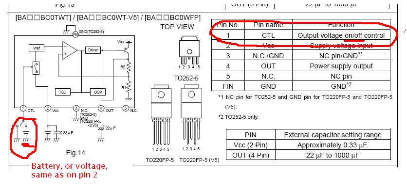

Now, about that CTL pin1. If it's supposed to accept a voltage higher than 2V, why does the schematic show it connected to ground? Taking Vin and GND at the same time? I'm confused.
Yes, I was confused too, because I was looking at a different data sheet. The diagram you use, the same one in my attachment below, shows pin one being used as a control, with the switch providing either voltage to turn the regulator on, or ground to turn it off. See, the little symbol has a bit shorter line, signifying voltage, the same as it is on pin two. A cap in their diagram has both lines equal length. So, apparently you have no problem. Just turn the thing on.

Connected Vin to pin1=CTL. Vout shows 11.82V, a working circuit. Yippee!

I would think there should be some voltage on pin 1 to turn on the device.
Yes, I would say you hit the nail on the head.
