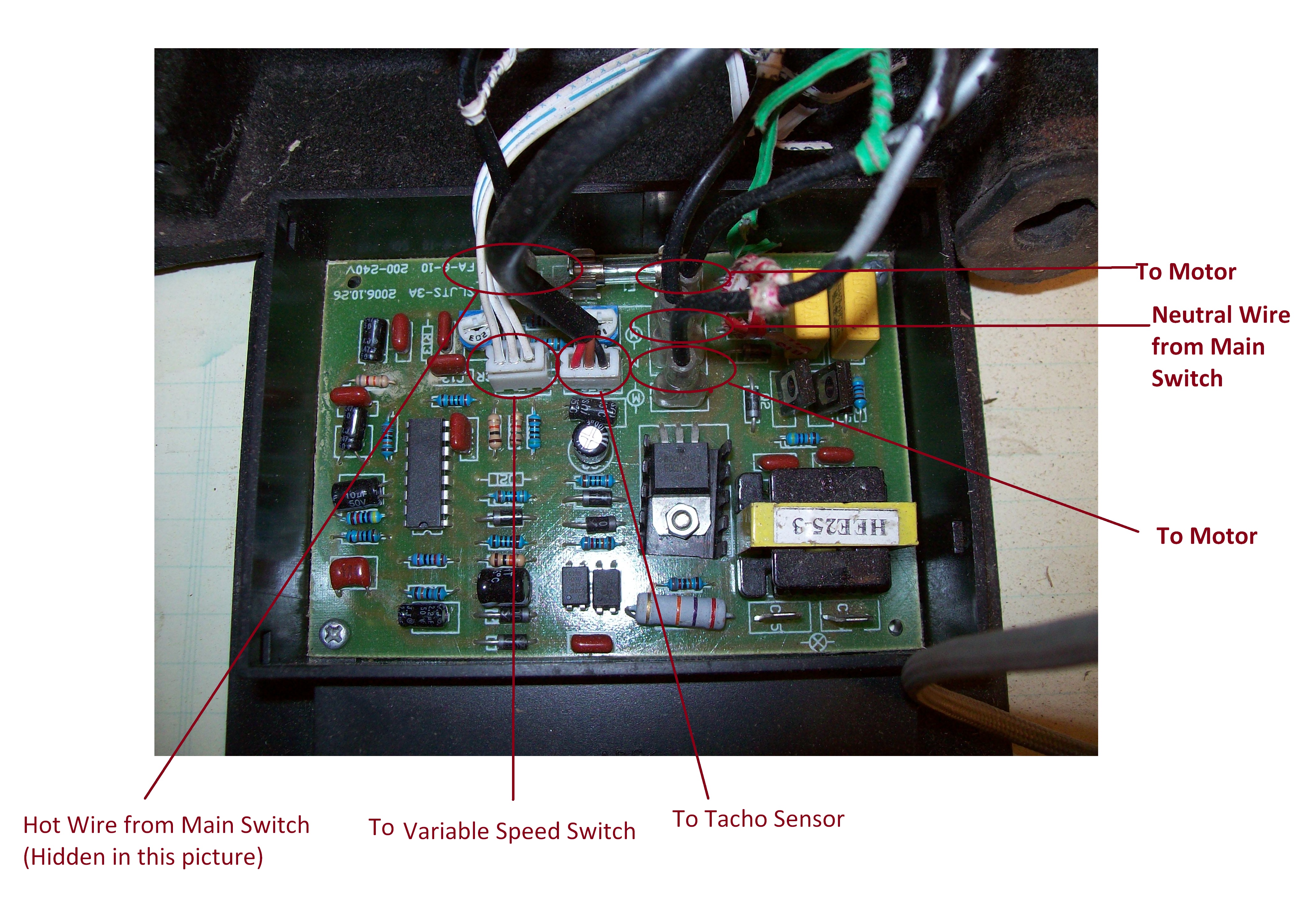

This morning I overloaded my bench grinder and it just stopped working. It is a variable speed benchtop grinder. I took it apart and discovered a circuit board, a lage capacitor, and a motor I am unfamiliar with. The circuit board had a small fuse that looked none the worse for wear. I checked it with my ohm meter and it appeared to give a reading on the 200 scale of 0.4 ohms. I don't know what it is supposed to read if the fuse is good. I thought that if it gave me a reading in ohms that it was intact. Next, I isolated the capacitor. It is a Dianz CB660 300V 18uF capacitor. I do not have a device that allows me to check capacitors so I went on to the motor. The motor has an unusual rotor. It is just a closed cylinder. I have no idea what is inside. The stator, on the other hand, looks like something I am familiar with. It has an iron core with copper coils. There are 4 wires that are part of the stator. There are 2 black wires that go to the circuit board and 2 white wires that form a closed loop with the capacitor. I checked the resistance between the two black wires and the resistance between the 2 white wires. I got a reading of 4.5 ohms and 11.5 ohms, respectively. I also checked the resistance between the black and white wires and got 4 different values for the 4 possible combinations. The first black wire and white wire A produced 4.5 ohms. The first black wire and white wire B produced 7.5 ohms. The second black wire and white wire A produced 0.4 ohms. And, the second black wire and white wire B produced 4.5 ohms. I dont really know what is going on here, so any help would be greatly appreciated.

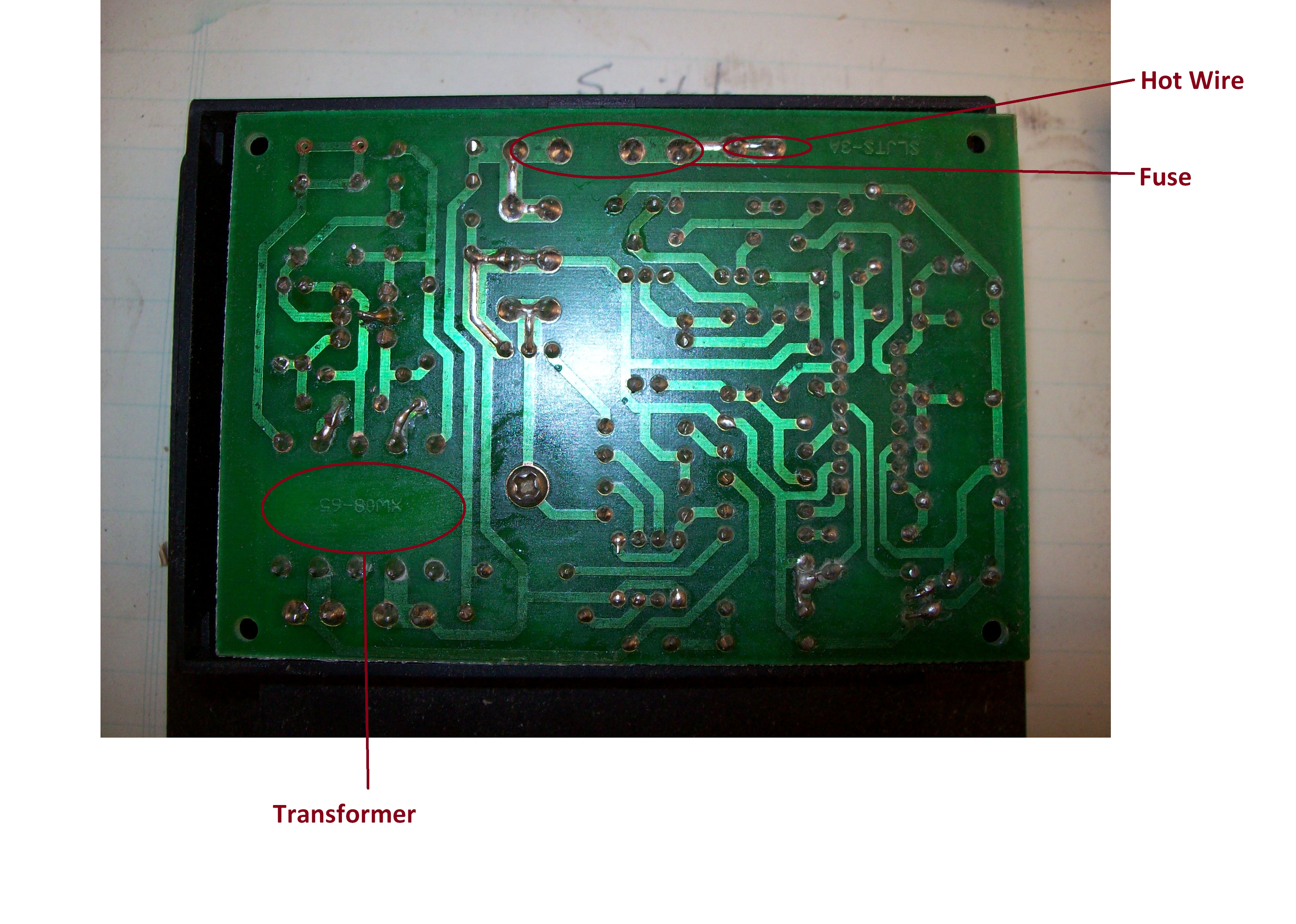

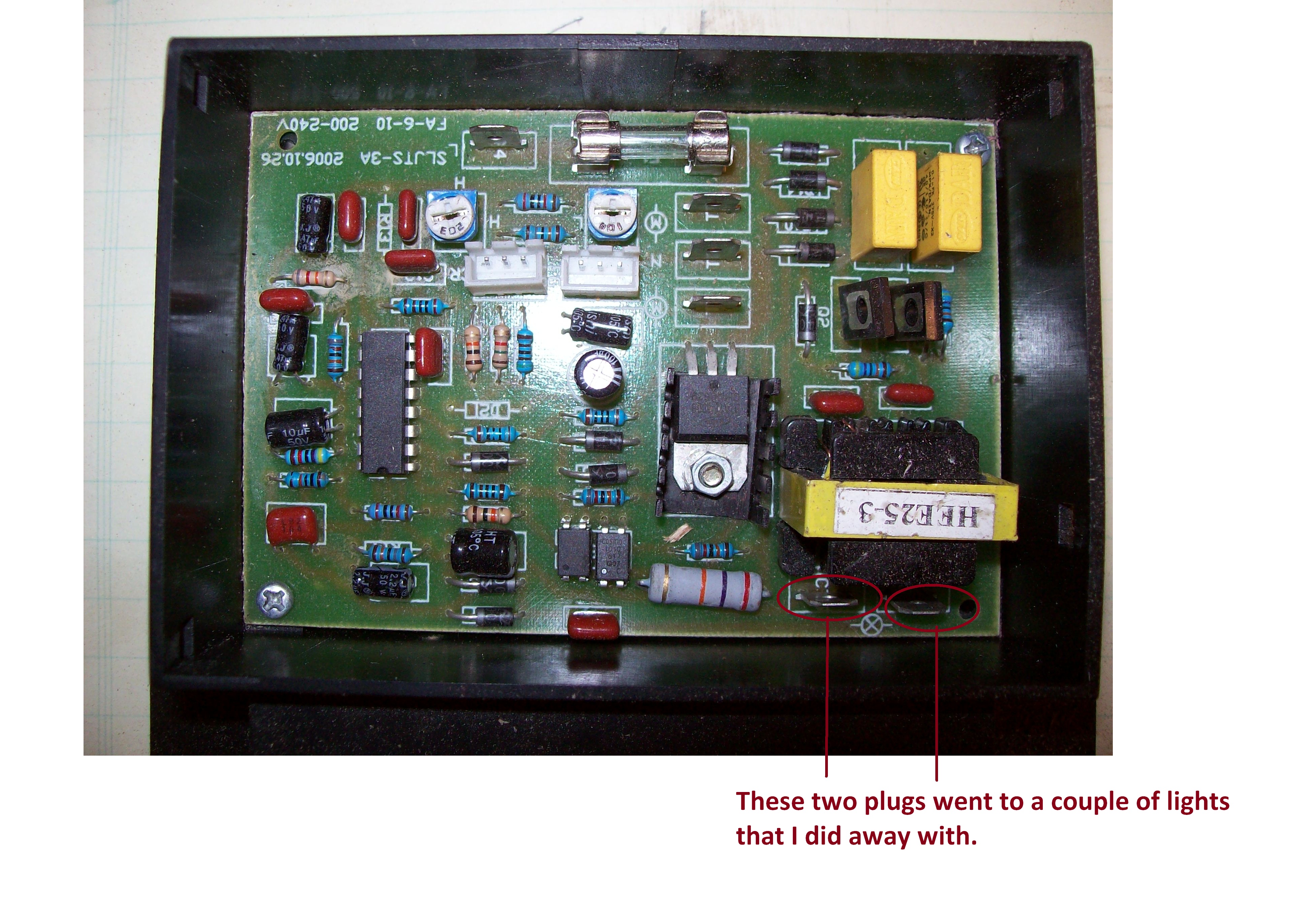

Ok. I circumvented the circuitboard by plugging the leads to and from the motor onto the output terminals on the main switch. I plugged the power in and turned the switch on and the grinder started working. At least we know it is not the motor that is the problem. If it is the switch that might be the problem, is there a way to just check to see if it is functioning properly instead of having to go into checking everything on the PCB. I believe the variable speed switch is a dimmer type switch like tunedwolf thought. The single line that leads to and from the switch has three wires in it. It plugs into the PCB. The other component that I believe is part of this variable speed function is a sensor mounted just outside the motor housing. There is a gear-type wheel that is fixed to the shaft of the motor whose cogs rotate through this sensor. There is a single line that leads to and from this sensor. It also has three wires in it. This line also plugs into the PCB in a similar fashion as the variable control switch. It actually plugs in right next to where the variable control switch plugs in. If it is necessary, I will take pictures of the PCB on both sides and upload them. Thanks for all your help.

If the shaft has a sensor on it, then the speed control is much more elegant than I originally thought, likely using a tacho of some kind for feedback. I will need some decent quality photos of the whole rig, both sides of the pcb, wiring, sensor etc to proceed with anything sensible. I can really only make assumtions from this point without something more to go on...

Ok, it looks like a variation of a washing machine speed control, most probably using a TDA1085C (16 pin chip) or one of the chips in that range. Things to check are the voltage across the 100uF capacitor sitting vertical right in the middle of the board in front of the Tacho connector. You should have somewhere around 14-16 Volts across it, if not, suspects would be the transformer, or the two square yellow capacitors at the corner of the board, or the diode in the middle of the two resistors where it says D21 or one or more of the diodes beside the yellow capacitors etc.
If the 15V is missing, lift one end of the diode above where it says D21 and try soldering a couple of wires to the pcb at the 100uF capacitor and inject a maximum of 15V, watch your polarity and voltage as a mistake here will blow the control chip, also remember to use an isolated supply, as one side of this supply will be at mains potential when connected. If the speed control runs ok, the problem lies with the power supply built around the transformer/ yellow capacitors. diodes and the scr's etc, if the speed control doesn't run with an external supply, then check the opto couplers and the 820K resistors, one of which is above the triac on the heatsink and the other in front of the optocouplers.
Obviously quickly check all the other diodes, but I think they are unlikely to be faulty.
It could be one of the small capacitors around pins 4-7 but again, without testing them there's no way to be sure.

The other day when I started checking the capacitor for voltage across it, I got a reading of 11.85 V. Unfortunately, I also broke the leads wire that comes off the dimmer switch. I have decided that the variable speed capability is not absolutely necessary. Therefore, I am not going to bother replacing the dimmer switch and then troubleshoot all of the possible things that could be wrong with the circuit. What I would like to do, however, is put a fuse in line with the power in order to keep from burning up the motor. The motor is rated for 2.5 amps. My question is: What rating fuse do I need, and Where do I put it exactly?
