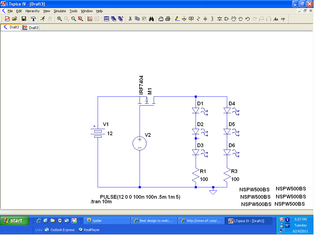

You say you are flexible as to supply voltage so lets revisit the idea of series/parallel. I think your objective could be met with the circuit below?
This would make the FET standard instead of logic level and lower the current requirement.
Had you planned on a resistor to limit the current through the diodes?

Also, in reply to your alternative ronv, that wont work. I should elaborate on my design a little.
I am making an 8x8x8 RGB LED cube. My plan is to have 8 MOSFETs sourcing current and 8 TLC5947s sinking current. This is why the MOSFETs must be connected to all the LEDs common anodes in parallel.
By multiplexing the MOSFETs I now have a 8*196 LED matrix. Also, before you suggest I split it into eight 8*24 matrices, this will not work because it is a 3D matrix (8*8*8 [*3 for RGB]) and doing anything else would greatly complicate the lattice.
I guess my original question might have sounded odd, but when considering my application, there aren't many alternatives.
Now given all of this, it is worth mentioning the MOSFETs will only have a 1/8 duty cycle, but I am still concerned with the heat.
