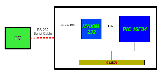

pic programming help
hello friends
first see this attachment
i want to program pic16f84 for showing 1byte (8bits) data over LEDs.i making this project but not work and i doubt to pic program. this is sample program.

please suggest a program or debug for this issue.
thanks
