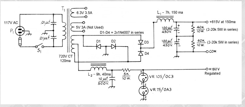

Possibly OT but maybe not as this thread seems to be going circular. I was always fascinated by the attached rectifier circuit. I first ran across it in the ARRL handbook and they did have some kind of name for it. It basically allowed one to generate two different voltage (for both plate and screen voltages) levels from one transformer secondary winding.
So in reference to this thread what words would best describe this rectifier circuit? Possibly full wave, center tapped bridge? Or possible it fits the bi-phase term many of us are struggling with here :p

Like most people here, I've never heard of bi-phase either - the circuit in question is two fullwave rectifiers (or a single bridge if you like). It's the same circuit used in almost anything with a split supply (such as audio amplifiers), just with the chassis connection at a different point (actually on the negative rail).
In the early days when using glass tubes/valves it was cheaper and easier to connect a centre tapped transformer to a dual glass tube rectifier in order to get fullwave rectification, it was called bi-phase rectification.
To get fullwave would have required at least two/four dual glass tube rectifiers.
Now we use a semiconductor FWB...

"It's the same circuit used in almost anything with a split supply (such as audio amplifiers), "
Well not exactly the same circuit. The common split supply uses the center tap to establish the common (ground) reference and generates two equal but opposite polarities, where this supply uses one half of the bridge diode to establish the common reference and generates two different voltage levels but at the same polarity. Surly it deserves a unique name :p
"Bridge rectifer with chassis connected to a different point" - hardly a snappy title :p
Exactly the same circuit, just using a different reference point.
