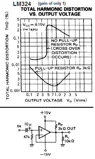

I've been reading about some experiments with op amps having their final stage working in class A by adding a current load from the negative supply rail to output, thus forcing the output stage to run single ended. From what i've seen most belive its a great tweak for the sound but what about the op amp is this safe? Did any of u tried it?

This eliminates the cross-over distortion, but has some drawbacks. When choosing the current you must consider the characteristics of the op amp: maximum output current, maximum power dissipation and the voltage levels of the signal. Also.. the load impedance will depend on the output impedance of the current source (FET?).

The old LM324 and LM358 opamps have a high amount of crossover distortion. National Semi who invented them recommend biasing the output in class-A to eliminate the crossover distortion. A Japanese company copies them and shows curves of the amount of crossover distortion. BUZZZ!
Some audiophiles must have seen it and tried it with opamps that have only 0.00008% distortion. They think that biasing the output in class-A makes their excellent opamps have even less distortion. Ridiculous.

The old LM324 and LM358 were the first low power opamps. They made them use less current by biasing the ouput transistors in class-B. BUZZZ!
All other opamps, even newer "low power" ones bias their output transistors properly in class-AB so there is hardly any crossover distortion.

Opamps don't use class-A output stages because they would melt and would have a high output impedance if they did.
They all use low impedance class-AB except for the old LM324 and LM358.
