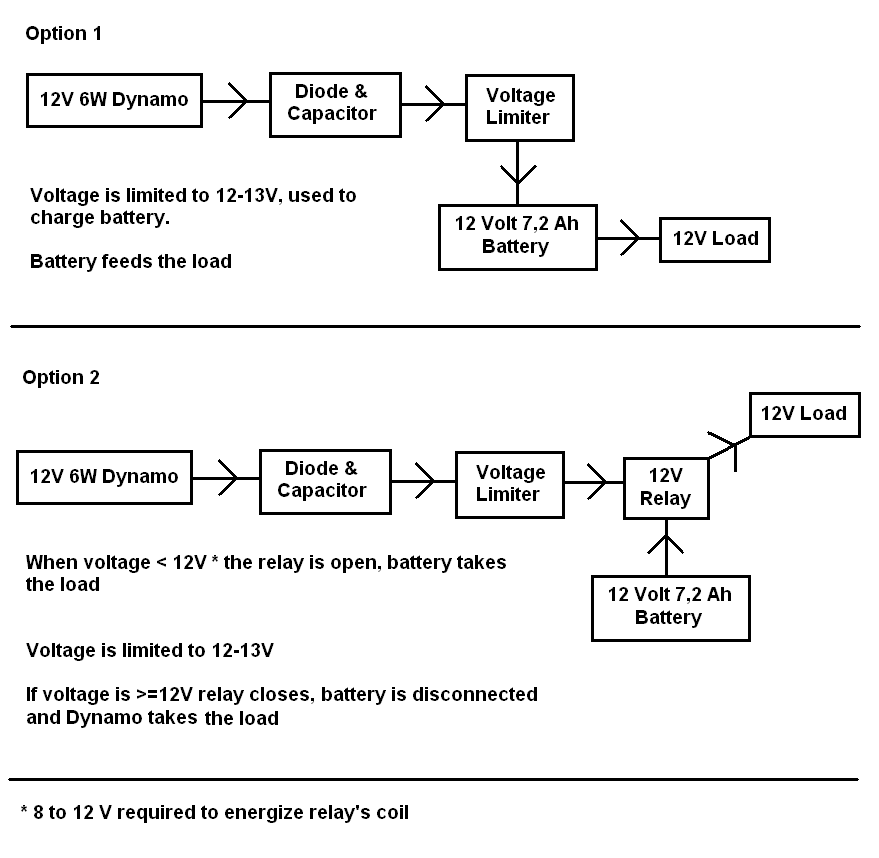

I just got an old Dynamo (alternator) and a light from the Bicycle Store, and I'm very happy with it. My bicycle is already equipped with a 12V 7,2 Ah battery to power a car horn and a small led lamp via LM317, but generating some electricity "on the road" is much more interesting.
I'm exploring two options (please see the attached picture).

A) In your opinion, which one of the two options is better?
B) Dynamo output voltage easily exceeds 12 VAC. It may reach 20 or more downhill, burning everything. 7812 regulator has too poor performance (too high input requeriments, bad regulation if voltage drops), so what could be a better option for voltage limiting?

Do a modified option 1. Run everything off the battery and add a full-wave rectifier from the dynamo to charge the battery. You don't need the filter or voltage limiter. The battery will act as a filter and keep the voltage from going too high.
Note: A full-wave rectifier gives the most efficient use of the dynamo output but it requires either that the dynamo have an isolated output or all the lights and horn be isolated from the frame.
If the dynamo is run directly in parallel with the battery it should eat any additional voltage created when going down hill charging the battery in the process, though it may produce some moderate breaking forces on the bike. You'd have to put a diode on the dynamo to prevent the battery from turning the Dynamo into a motor, however if you wire a good circuit up this might actually provide a little extra starting torque.
cruts, if this is a bike dynamo it's output is already DC, I don't think rectification is required, although filtering would be, in parallel with the battery it will provide the filtering. My only concern would be the amount of breaking force applied at higher speeds on the bicycle, however this would just add to the workout if that's what you're going for =) When the dynamo is producing less than the voltage of the battery it would effectively be electrically disconnected because the diode used to prevent the battery from discharging into the dynamo would be reverse biased, as the battery voltage drains substantially this will allow the dynamo to charge the battery and provide the rest of the electrical system with power as well. If a large enough capacitor bank was used it may even be possible to completely eliminate the battery, however then you'll have to deal with the possible higher voltages when the bike is traveling at high speeds as the battery won't be there to gobble up that extra voltage. Also if the capacitor bank was completely discharged like when you first start riding it would be very difficult to pedal the bike until it attained a moderate charge level.

Again, I don't believe anything need be done about the higher voltage the Dynamo can produce, if connected in parallel with the battery the circuit should never see that voltage, the battery will act as a low impedance load when it goes over the batteries voltage and the current will flow from the Dynamo to the battery, the increased voltage shouldn't manifest in the circuit.

That's right Crutschow. Before mounting the alternator, I turned the rotor with a drill, then with a dremel. Output voltage with the drill stayed at 16 volts, but with the dremel it reached 48 volts VAC.
Since the picture of the dynamo shows a two wire output it apparently is isolated. Thus you should be able to use a full-wave bridge rectifier connected directly to the battery. That should be all you need to charge the battery.
