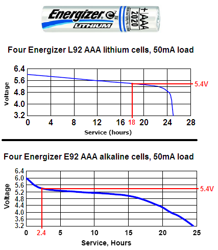

The viewing angle of the LEDs on the vehicle will be wide (especially when it is sliding on its side!). Then you need wide-angle LEDs. Most very bright LEDs have a focussed very narrow angle and can't be seen if you are not exactly in the beam.
A 3V alkaline battery with a load drops to about 2.4V very quickly. Then the voltage drops slower to 2.0v when it can be considered dead. Use more cells.
"1.5V" alkalines are only 1.5V for the first 5-10% of their life. It's the worst of both worlds - You have to cope with 1.5V when new, and then you have to deal with 1.2V to 1.0 which is what alkalines provide for most of their remaining life. Example: 3 cells start at 4.5V and fall quickly to 3.6V and eventually to 3.0V.
I use NiMH almost exclusively now because they have a much flatter voltage output.
Energizer's lithium throw away battery cells hold their voltage up much better than alkaline cells:

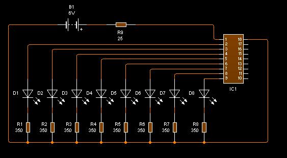

I think I will start with the Hall Effect sensor. The one I thought I was going to use turned out to be
Linear :( and requires min 4.5V. Data sheet: https://www.ortodoxism.ro/datasheets/allegromicrosystems/3503.pdf
It seems to be the only one that is readily available, but if I use ADC on the PIC would I be able to use it still? or would that over complicate things?
Even if I could use it that means I need a minimum voltage off 4.5V, so I will need 4 1.5V cells, 6V, as 3 batteries wont last long enough and 4.5V is the minimum voltage for the Hall Effect Sensor. The Hall effect sensor has a maximum rating of 6 V, so no resistor is required for it.
Now according to my calculations (which I don’t trust for a second) I need a resistor of 25 Ohms on the PSU of the PIC, because it has a maximum rating of 5V and 25 Ohms will provide the necessary voltage drop.
Then, going with either the yellow or orange LED, @2V I will need a 350 Ohm Resister per LED.
Correct?
I know the Pinouts arent strictly correct, but have I got the general idea?
Instead of the 3503, check out the 3213:
Even though it's described as being "micro-power", it has a duty cycle of 25% and is awake 3,000-4,000 times a second which is plenty resolution for your POV. Also, it has a minimum supply voltage of 2.4V which makes it very nice for battery powered applications.
Also, don't use a resistor to regulate the voltage to the PIC - your supply voltage will vary wildly as the PIC varies the amount of current it uses. Just try to work things out so you can run everything straight from the batteries.
