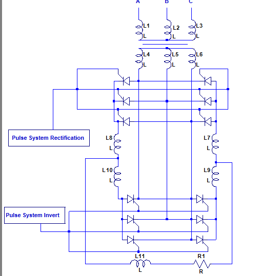

hello, i need the schematic diagram for bidirectonal thyristor converter PS( pulses system) and the way in which the circuit operates.I've tried through google but didn't find what i want exactly so i might have done wrong so plesae correct me to the right thing.

what i'm looking for is the pulse system circuit (which is intended for triggering the whole thyristors in such a way that enables the two sets to work in the desired way)
thanks in advance!

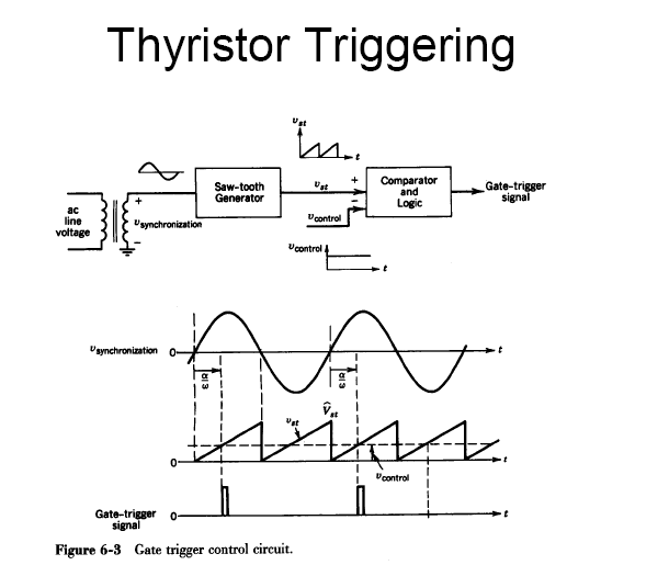

Might be useful
Even though they are controlling a DC motor via an AC sourced SCR bridge rectifier, you might want to look at the "universal firing circuit" descibed here:
But to control a DC motor using a DC supply, I think you should be using MOSFETs and not SCRs. To use SCRs you will need a large commutating capacitor to turn off the SCR because they are latching devices on DC.

There are many pulse systems differ by changing firing angles between the set itself and also between the two sets(rectifier+inverter) but i think that the most useful practical way is "seperate control" which depends on sending pulses to one set and removing pulses from the other sequentially....
I need help concerning PSR and PSI cause all that i know is the chart symbols for each of them so i need the real practical circuit used in such cases.
where VA,VB,Vc are 120 phase-shifted of each other.
