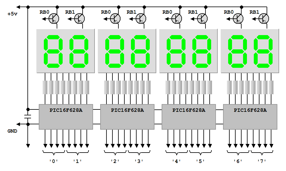

I have 8 sets of four binary output pins (8 hex characters) which I want to be displayed on an 8 character Hex display (7 segment LEDs)
I know how to convert 1 set of four binary into 1 hex character using a decoder chip- but how do I get all 8 to display?
The ideal solution would be individual 7 segment Led's with an integrated decoder (4 binary inputs)- but I cant find any?
I have limited space on the PCB so the fewer components the better.

Would something like this fit (four 18-pin ICs, 8 transistors, displays and resistors)?
That would certainly fit in the prescribed area and would still be quite cheap.

The only qualifier for the displays is that they should be non-multiplexed, that is they should have seperate pins for each segment and CC or CA digit connection. This a limitation of the type of multiplexing that must be used for those 18-pin PICs, an N(N-1) multiplexing or Charlieplexing scheme, which allows us to drive the displays with just 8 pins.

Most moder PICs have an internal RC clock. Stick with the 16F628A for your project.
Another possible choice but probably a tough find nowadays would be a GAL, PAL or PEEL (no clock needed as it's just a simple logic device)
