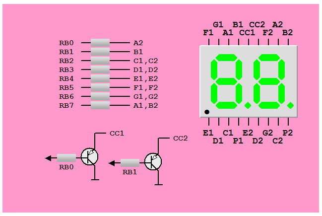

I was just looking at some 20 pin atmels on ebay- just checking out the options- I'm more than happy to stick with the pic chips, though.
I was looking over the circuit diagram, and I'm a bit confused...

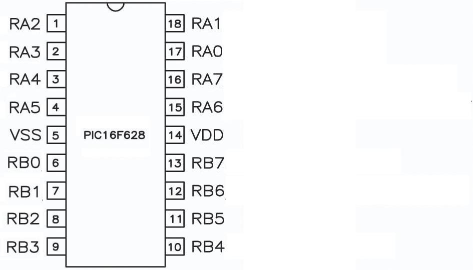

Here is an edited diagram and the pinout for the pic processor...

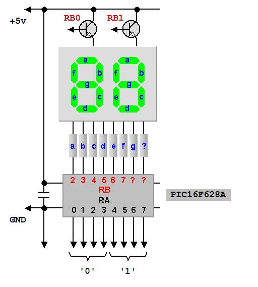

Heres what I dont get...
The pic has 15 i/o pins, but it appears I need 17 i/o pins:
8 inputs for the binary bits.
7 outputs for the led segments and
2 outputs to switch between the 2 digits.
Am I missing something there?
Also, there are 8 resistors going from the pic chip to the display? is that just a mistake or am I missing something there too (I thought there should only be 7 as I dont need a decimal point).
Let me know if I'm being daft...
Thanks again.
-DAlmation.

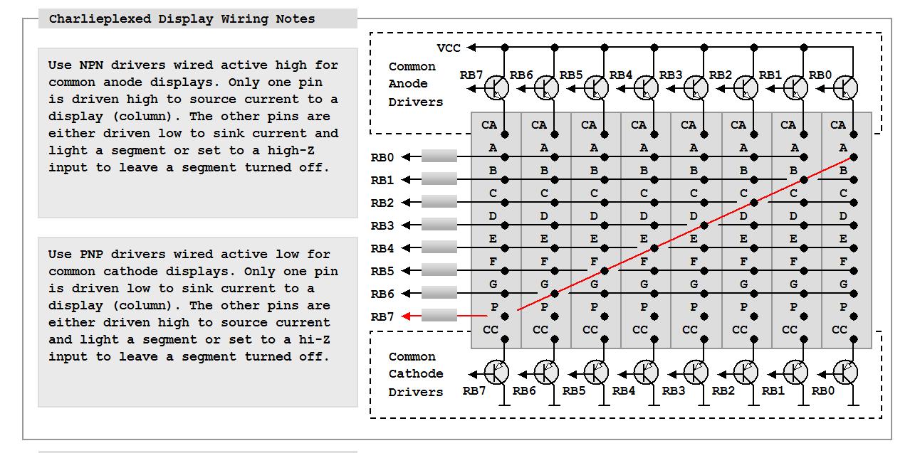

You are not being daft. You have however miscounted the I/O on the pic, it's got 16 I/O lines. As you rightly point out, it appears that you need 17 I/O pins, this is because of the way charlieplexing works. If port B is used to drive the display then it is connected so that bits 2 to 7 go to 6 of the display segments and bit 0 goes to both the unconnected segment on display 1 and display 2's common transistor. Bit 1 goes to the unconnected segment on display 2 and display 1's common transistor.
It might help if you google charlieplexing. Although, the above is not strictly charlieplexing (edit, according to wiki, the above is exactly charlieplexing).
If I understand you correctly- there is no way the circuit will function with only 16 i/o pins- I need 17 pins or a different circuit? Is that correct?
Is it is, could I make it work if I replaced the two transistors with 1 component- some form of solid state switch (functioning like a relay, toggling the power from one digit to the other, depending on input being high or low)- all synchronised with the display i/o pins outputting the 2 different characters.
That sound reasonable?
Thanks.
-Dalmation.
No, it will work fine with 16 I/O pins. Google charlieplexing and it should make more sense. Having read what I posted above I can understand your confusion, I should have stated it more clearly.

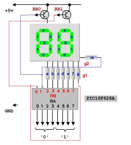

I think I know what you mean now...
basically, like this (g2 being the missing segment of the 2nd digit).
That look more reasonable now?
I plan to use common cathode LED displays- that will just involve swapping emmitter and collector on transistors- right?
Thanks guys- I appreciate the help.

The Charlieplexed display uses 8 pins for both segments and columns. Just imagine we're using the first two of the eight displays shown in the graphic below.
I hope to start writing that code soon Sir.
Mike
Wire the display like this (sorry for the crude drawing);
Can't help you with the Atmel chips. Sorry.
Mike

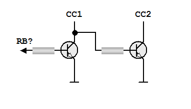

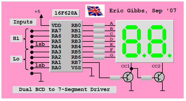

Eric (Ericgibbs) contacted me off list and he's got a much simpler and more elegant solution that doesn't involve the screwy Charlieplexed display wiring and code. His method uses your suggestion for using 1 pin to drive the common cathodes on both displays.

Hi Eric.
You've got a few lines of code that aren't really doing anything. Other than that your logic is fine.
I would make it a little tighter and simpler but that's just a style difference. In the example below the basic logic and function are unchanged, except for (1) the loop time is constant for either digit now, and (2) digit segment data and the digit select bit are written at the same time to prevent image blur or smear.

Do you think there might be any problem scanning the display at such a high frequency (something like 20-KHz)? Anyone?
hi Mike,
That looks fine, much more compact.
I will have to get a couple of 628A and give it a try in real time, as we both know simulators do have limitations.
I did consider the high refresh rate [20KHz] but the spec on my FND357 LED's indicated it would be OK. It would be interesting if one of the OP's, who have been asking for bin2hex drivers gave it a shot. For about $2 its much more cost effective and has a smaller on board footprint than discrete ic's.
If the refresh rate is too fast for some LED's a short inter LED delay would be easy to implement.

Does this look correct? Conventional wiring to multiplexed or non-multiplexed common cathode displays.
Looks the same as my sketch.
This is what I was thinking (I was gonna use an npn and a pnp to achieve the same thing, but this is better).
If I understannd correctly- when the RB? is HIGH, CC1 wil be active- When RB? is LOW, CC2 will be active. Is that right?
Thanks again guys- theres no way I could suss this out on my own.
-Dalmation.
