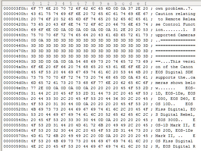

Yeah, sometimes the 'requests' are like projective tests, but I was thinking along the same lines - thought the OP was after something like this:
