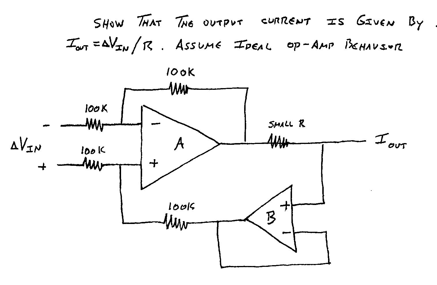

Can anyone help me with a formula for the following circuit?

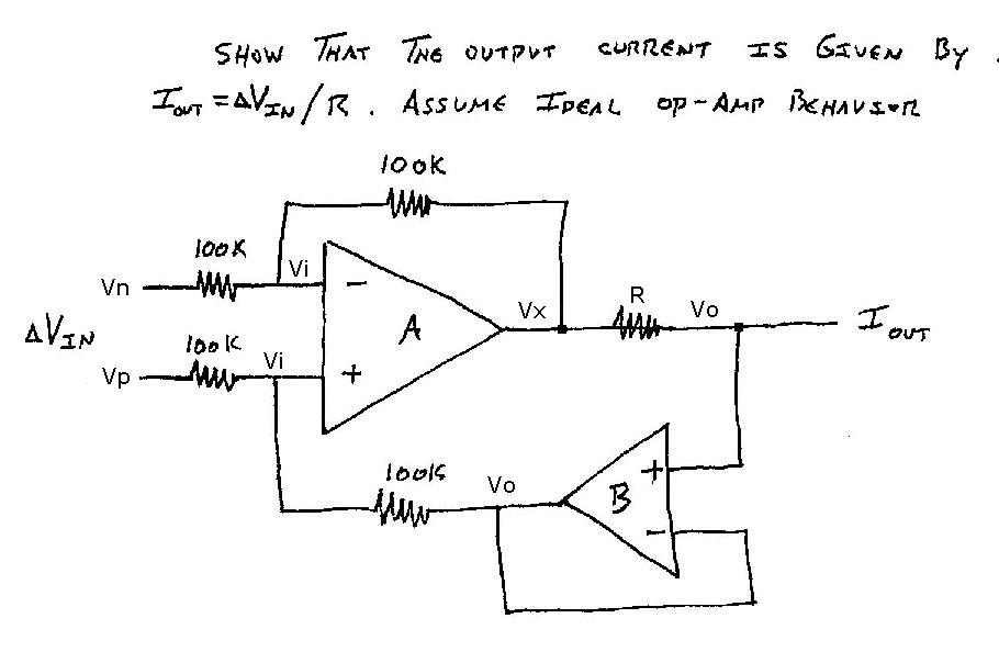

This is probably homework, but I can't resist.
(Vp-Vi)/100k=(Vi-Vo)/100k, so
(1) Vp-Vi=Vi-Vo
Note that, assuming overall negative feedback, which you will have if Rload < infinity, that the op amp's inverting input voltage will equal Vi, the voltage on the noninverting input. Therefore,
(2) Vn-Vi=Vi-Vx
Combining (1) and (2),
Vx=2*Vi-Vn, Vo=2*Vi-Vp
Vx-V0=Vp-Vn=deltaVin
Iout=(Vx-Vo)/R, or
Iout=deltaVin/R
Q.E.D.
