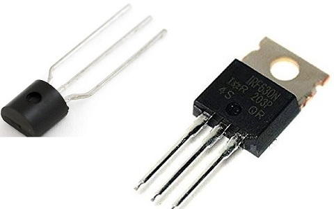

There is a difference between BJT (little) and BJT (power). Most people do not know how to make a Power BJT work so they have moved to IGBT which is a BJT with a MOS-Gate, also, people use MOSFETs for power because they are fast and easy to use.
Good cause I was concerned. I seems like most amps and inverters have strictly moved to MOSFETs.
As far as I'm aware most amps still use bipolar, unless you're talking Class-D amps? - there was a short term 'fad' for FET amplifiers, but it didn't last long, too expensive, too unreliable, and their supposed 'benefits' weren't true.

Depends upon the application.
BJTs often work better for small signal linear circuits.
MOSFETs or IBTs often work better for switching or power circuits.
