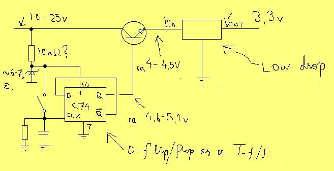

I might have been overly descriptive above. So sure. There are 4 blocks mentioned above. A resistor-zener diode, a flip/flop-circuit, an npn transistor and a voltage regulator.
The flip/flop is powered by the zener. The resistor above the zener is connected to the car battery +. The car battery + is also connected to the collector of the transistor. The Q from the flip/flop is connected to the base of the transistor. The emitter of the transistor is connector to Vin on the voltage regulator. Vout of the regulator is connected to.. whatever there is.
Sorry I don´t have an image but if you don´t get the picture this time I don´t think you´d be able to read a decent book.

Here you go
Ok, now nothing is left to (lack of) fantasy anymore. (Advice; read some good books too, not just Data books ;-)
And so to be clearified. I would like to see this, or equivalent, in an existing chip and as said, I would pay for getting that info.
Oh, I see what you want now. If you want a toggling function, you will need a flipflop in the configuration as you suggested, there is no way around that. I am curious to see why you have chosen that particular zener diode in place of a regulator, which isn't any more complex then a zener/resistor and will offer superior performance.
As for your scheme to drive the flipflop, it will not work all of the time! You need to debounce this switch or else it will be a game to which state it will be after you pressed the switch. There are several circuits and even chips that will do this function effectively.

Why would curiousity arise?! Zener diodes are cheaper.
This is to be used in several products and it will probably be changed a little here and there but basically the same. Cost is a factor. Only if I was given free components I would have used other types.
The supply voltage to the f/f is of course not critical. I tried 50k for the resistor and "7.5 V" zener which gave ca 5 Volts. And the micropower references cost a lot lot more than the standard models. But why waste money at all? The voltage at the transistor emitter gets to around 4 Volts when using a darlington, which is a condition in order not to draw too much current from the flip/flop which otherwise might lower the voltage below 2 Volts. Maybe it could do anyway because the flip/flop did the job even at 1 Volt. But the darlingtons available as cheap as standard transistors so I rather use them.
As I said, the f/f-circuit shall draw as little power as possible as long as Q=L, shunted to the zener voltage circuit. I measured some 0.2 mA which
could be ok.
The RC-combination i tried as a first try was 1 MOhm and 39nf. If the resistor is too low it will affect the zener voltage when pressing down the switch.
There is no need for de-bouncing circuits. Just a big waste of time, space and money! The capacitor filters out most micro spikes. It worked quite well even cable-to-cable. Since small switches today are of a non bouncing type they can almost be used without a capacitor. Now, with a switch type as that and the capacitor, it worked with no bouncing at all. I tried i
t hundreds of times. No bouncing. And never in earlier projects either.

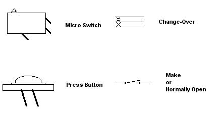

Hi Dix,
Could the press button that you use for this
have changover contacts, if you wanted it to ?

You say the press button can not have changeover contacts?
Thats a shame, cos i was thinking along these lines.
Drg attached.
Never mind, there might be another way with a small SCR.

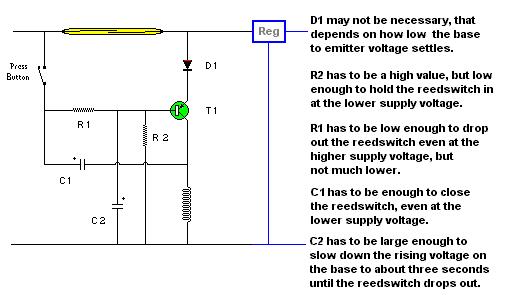

Hi Dix,
From your first post: 'i thought it would be easy... '
Well i thought it would be easy too.
What i found awkward was getting the 'OFF' current
to be none,
that is, no current when 'OFF'
With a changeover contact set on the button, i feel it
could be done, although ive given up on that cos you
can only use a single make contact.
I have come up with this possibility for you.
When the button is pressed, two things operate together.
One straightaway,
the other takes a few seconds, maybe three seconds.
I will assume that this unit has an indicator lamp.
When the button is pressed, the reed-switch is engaged
through C1, when engaged base current through R2 will
keep it closed and the user can remove his finger from
the button,
and also a capacitor connected to a transistor starts
to lift the base voltage, after about three seconds
the reed-switch would drop out. No further change.
So to switch on the button would be pressed,
then released, within three seconds.
The indicator should stay on.
Then to switch off the button would be pressed,
for about three seconds, the indicator would go out.
You can adjust the timing to suit what you think.
Briefly, to switch off you press a little longer.
As you can see from the diagram, when in the 'OFF'
position the circuit draws no current.
It is not a flip-flop as you originally wanted, but
it operates very similarly.
The diode was added as an afterthought, it may not
be needed, that depends on the other components,
it is to make sure that the rising base voltage will
reach a point when the reed-switch drops out, then it
will stay open until the user takes his finger from
the button and allows the circuit a moment to settle.
I almost gave up on this circuit a few times, i feel
this arrangement is use-able and easy to make.
I like it so much, i will probably use it myself.
Regards, John

Errata:
Re above circuit, i think a few hundred ohms in the
base or emitter line would be a good idea, in case
there is a bit of a surge from C2 when the reed-
switch closes. Depends how the values work out.
John
Errata:
Yes definately.
i think maybe 700 to 1000 ohms,
to slow C2 down a bit.
Straight on the base.
John
