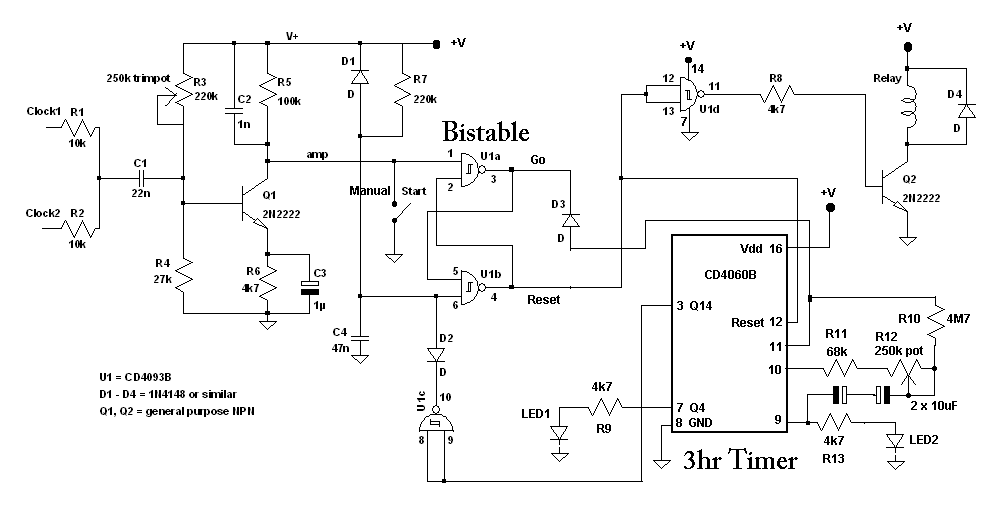

Bistable re-triggers if any voltage fluctuation occurs in main !
yusuf
Hi friends !
If any voltage fluctuation occurs in main supply or If the electricity goes and comes immediately this circuit triggers and the 3hr timer begins to run..
But I want it should not run until I touch the manual switch or it gets pulse from the analogue clock beeper..
And I wan to run this complete circuit with 12volt power supply because it contains 12v relay..
I have tested this circuit with my 7vdc adapter.. and the 3hr timer doesn't run until I manually touched the switch or it gets clock pulse.
But ...
The problem is as I power on my adapter first time ...
all circuit is off...
As I touch the manual switch the 3hr timer begins to run....
but as it runs I turn off the adapter and switched back on again immediately...
And the result is the 3hr timer & all circuit starts to run... without touching
manual switch..

Friends , I am using 12v relay for switching on/off.
So If the 3hr timer circuit runs properly at 7volt then How should we run the 12 volt relay...
Because as I connect any power supply with is greater then 7 volt then the 3hr timer
starts to run immediately without touching manual switch...
I have analyze the complete circuit deeply and the what result I got I have mentioned above :
Kindly have a look... friends
And ,
I want this all circuit should work with 12volt power supply because we have to switch on/off the pump with 12volt relay...
and also fluctuation free...
Because any fluctuation in mains run the circuit unnecessary without touching the 3hr timer manual switch..
Please have a look !
Hoping for your kind co-operation :

You can make one with a simple RC network that will hold the reset inputs low or high until the power has stabilised.
Edit:
Replace C4 with a larger capacitor value, make it at least a 1uF cap and see if that makes a difference in your circuit.
Ok I have done this.... as you said ... I have increased it's value to 1uf.
and the result was :
If I connect the old battery (7v) is stay off as it deserve..
but IF I connect now 9v new battery then this circuit stays off.. but after a few second it starts again without touching manual switch !
This circuit is now working well with fluctuation free...
Thanks..
But it only works with 7volt...
As I replace 7v with new 9v battery then the circuit wait for few second then it starts to run.. without touching manual switch...
<---------- now this is a problem !
But with 7volt old battery and adapter it works fluctuation free ....

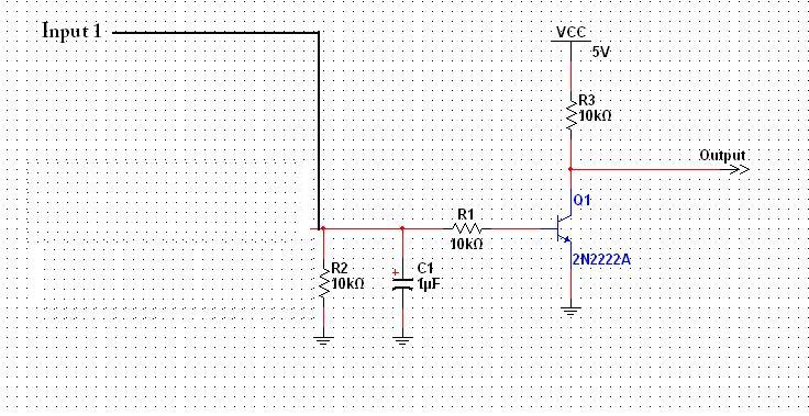

Your amplifier circuit does not need to be there if it just connected to an alarm clock. Simply replace the amplifier with a sing 2N2222 transistor with a 10k resistor on the collector, and a 10k resistor on the base that connects to the alarm clock. Each alarm clock input will need its own diode so that they do not short each other out, they can both use the same 10k resistor. The emitter of the transistor should connect directly to ground. The input for the trigger will connect to the collector of the transistor, and this will be the output of the circuit. You must make sure that both circuits have a ground in common otherwise they can cause false signals or even damage each other. For the pull up resistor on pin 11, make it a 10k. I would also make C4 much larger so that the circuit the timer circuit has time to stabilize, and the alarm clock also has time to stabilize. Make C4 a 10uF to 100uF cap, this should give a large enough time constant for each circuit to stabilize.
Edit:
Add a 1uF capacitor to the diodes that are from the alarm clock, connect this cap between the diode and ground. You will also need another cap in parallel with the cap to discharge it at a fairly slow rate. Make the resistor a 47k. Both of these will create a peak detector so that high frequency inputs from the alarm clock will be ignored, and only large overall inputs will trigger the circuit. If it seems like the peak detector is not doing a good enough job, increase the value of the resistor or the cap to create a larger time constant.

Here is the schematic of what your new input should look like. You still have to connect the alarm clock to the timer schematic through their ground. Other wise they are both different circuits and will not work properly.
Your circuit is not working properly because when power is applied, the circuit has to stabilize before any activity can start. When the battery is first applied, there is a lot of noise in the circuit that the circuit needs to ignore before all of the voltages settle at their proper levels. That is why I stated that you should increase the value of C4, it will increase the amount of time that the circuit ignores the noise before it starts working.
The alarm clock itself may be the cause of the problem, if it runs off of the mains frequency for timing, then it is possible that there is on voltage regulator inside the circuit. If that is the case then your timer is detecting the voltage ripple that is in the alarm clock and is mistaking it as an input signal. That could explain why the circuit works at 9V and not 7V.

You might try a 390k across c4. Otherwise you may need a better power on reset circuit to assure the latch is reset on power on.
Also the clock circuit is very noise sensitive and could be picking up noise from the plugging and unplugging of the supply. What are the voltage levels on the clock signals. You might be better of filtering those on the input and creating the pulse inside your circuit.
there is no start up reset circuit in place to force the timer into a reset state after power up
I disagree. I designed-in the power-on reset circuit consisting of D1, R7, C4. Increase C4 as Dragon Tamer suggests, if you wish; it will hold the reset state for longer.
can you explain why this circuit work properly with 7v and not with 8v or 9v etc..
Yes. The circuit was designed to use a 6V supply, not a PP3 9V supply (a PP3 battery wouldn't last long). I advised you in previous posts that you must adjust R3 so that the collector of Q1 is at about 2/3 of the supply voltage, i.e. about 4V for a 6V supply (6V for a 9V supply). If you use >6V (why would you want to?) you must adjust R3 and also may have to reduce the value of R4. Simulation shows that R4=22k would be ok for a 9V supply.

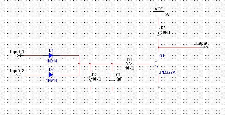

But with adding diode at the output of clock.. The clock circuit can't trigger the 3hr timer...
But it is working properly by removing the diode and connecting directly as shown in my circuit diagram which I have attached.. !
But I want to use three analogue clock so ....
Here there will be three input...
So how should..... I accomplish this task...
I have following diode in my workshop :
IN4148
IN4007
Friend one more help !
Now this circuit work from 9v and more then 9v also properly...
And by increasing the size of c4 it has done the work...
But I need one more help...
As I turn on my adapter the circuit stays off...
As My clock alarm starts , it triggers the 3hr timer...

Secondly, your circuit is most likely resetting after you apply power to the alarm circuit because there is a voltage spike on the alarm output during start up. Find a way to suppress this with a start up reset timer which disables the output of the alarm until a certain amount of time has passed, or add a minimum length timer to the input of the timer circuit. A minimum length timer or a "de-bouncer" would only accept a signal that is longer than the programed time. The peak detector that I posted will not suppress the start up spikes, it will actually detect them as a valid input and trigger the timer.
The easiest way to ensure that there is no false triggering is to have both the alarm and the timer receive power at the same time. I am wondering why you are going through all this trouble to test them if they are intended to stay on all the time in first place. If they both receive power at the same time then the timer's start up reset would force it to ignore any start up spikes from the input of the alarm while it is starting up.
